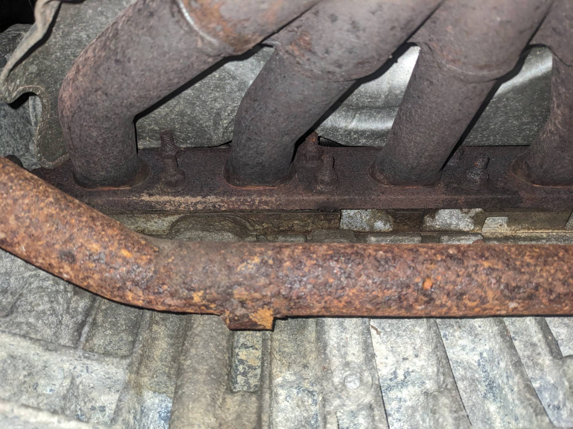

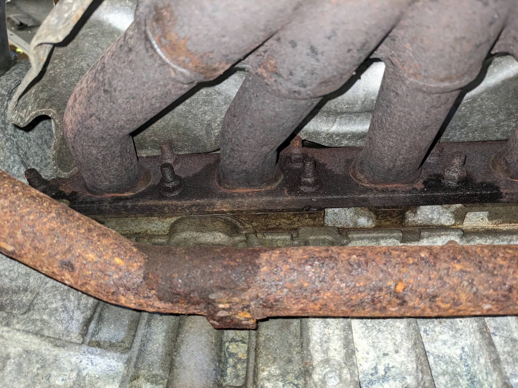

Those pics don’t reveal what area above the heat shield is allowing something to run down just above the #4 exhaust primary pipe.

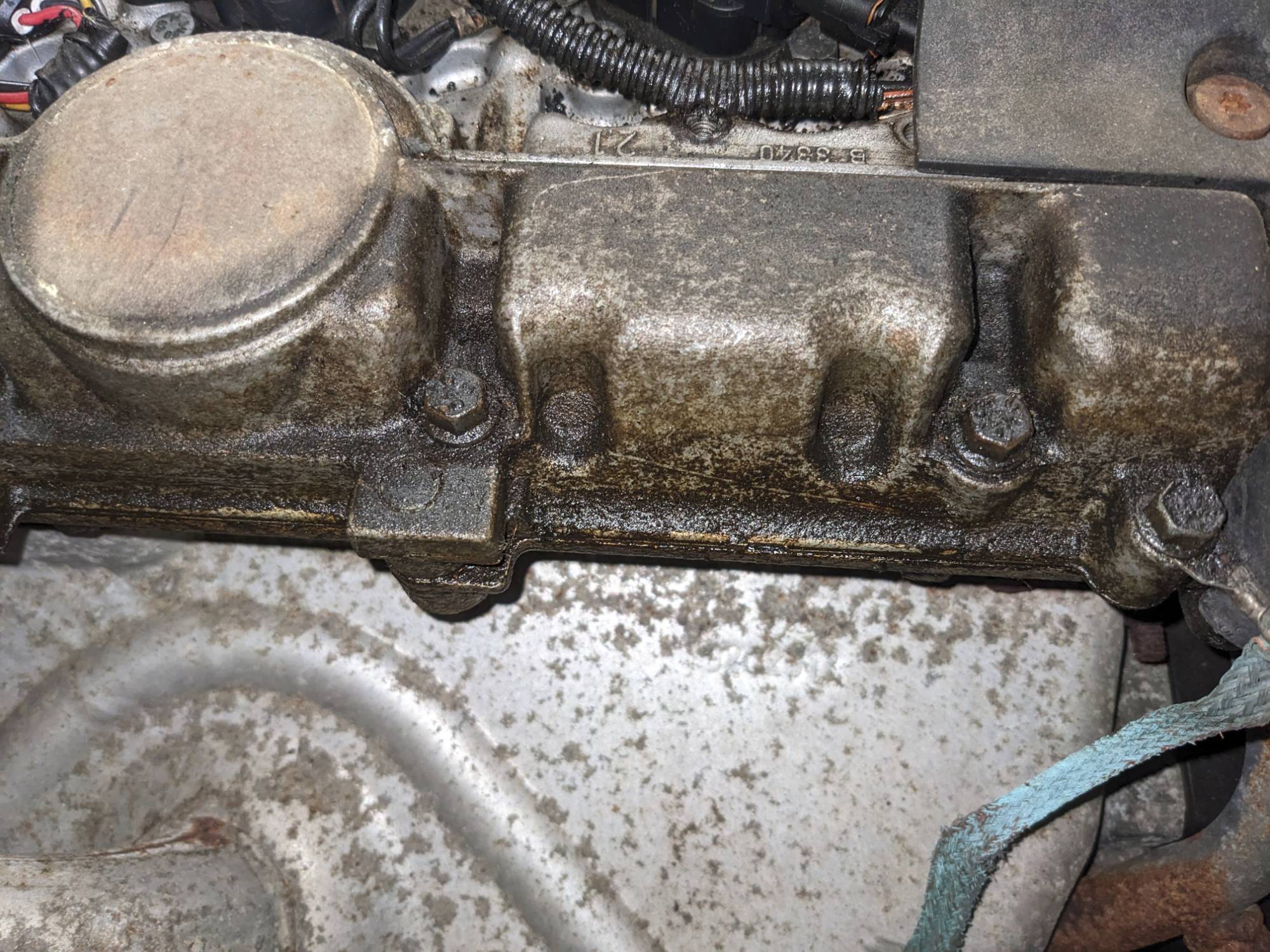

This post was really helpful. I finally took another look at the leak and it might be coming from the back of the valve cover. The majority of the engine is caked with oil stains but it looks actively wet back there. From the underside when looking at the exhaust manifold, the port for cylinder 4 blocks my ability to see if oil is running down from above.BlackBart wrote: 22 Jan 2023, 12:35 If it’s spraying oil, from where?
1. Running down from valve cover?
2. Head gasket somehow wicking oil?
The car is losing a lot of oil, about 0.5 L in 1600 miles. Some might be burning, the rest is leaking.
Is there a good way to test and confirm a leaking valve cover or head gasket? I just got a smoke machine. Could that be hooked up somewhere? How hard is it to reseal the valve cover? I did the job on my 2002 Mercedes (two small covers on a V6) and survived.

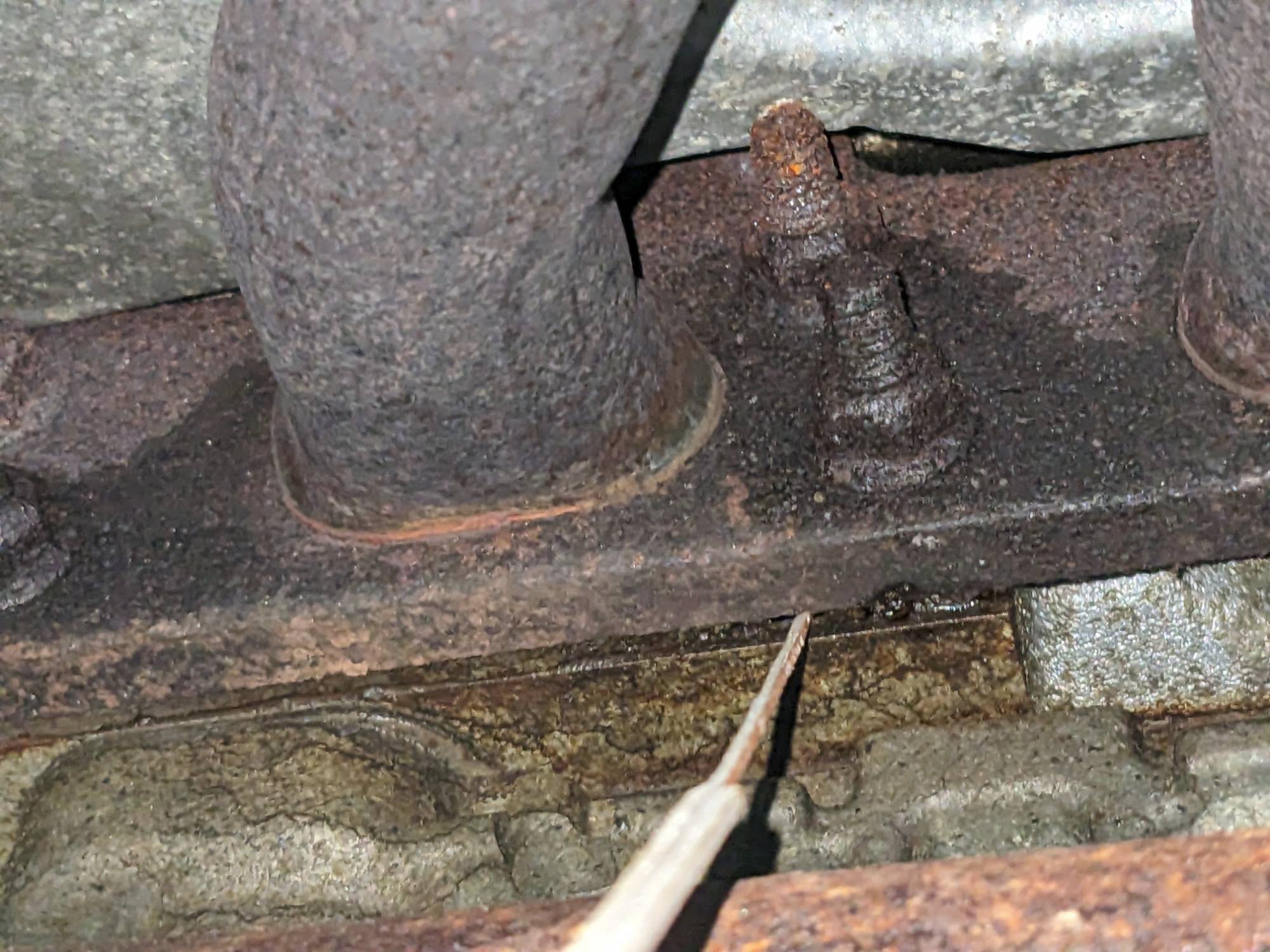

I investigated those tiny holes between the exhaust manifold and the block. There's a tiny hole below cylinder 4 and 5. I was able to poke a thin piece of wood into each hole. Surprisingly, I saw the exact same holes on my other 2000 V70 NA and it's not leaking anything from them. I guess I'll ignore these and not blame them for the oil leak.
Thanks again for your help. Once I get this resolved, I'll feel better about doing other work on this poor neglected car.
