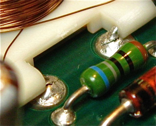

I also found cracks in the solder joints for the relay. It would be a good idea to check those joints too -- if you haven't already -- to make sure they're still good and solid.

jreed wrote: 29 Oct 2022, 06:32 I also found cracks in the solder joints for the relay. It would be a good idea to check those joints too -- if you haven't already -- to make sure they're still good and solid.
Wow that one looks bad. Ok i'll check that too thanks.

There are some more images of the relay and locations of the cracks available here:
viewtopic.php?f=1&t=33696

jreed wrote: 30 Oct 2022, 07:58 There are some more images of the relay and locations of the cracks available here:
You probably could just touch those solder spots with a needle point and reflow them
