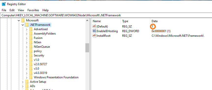

After doing some digging I fixed this error within the REGEDIT
I had to change {DEFAULT} data from 0 to 1.
getCommToolSettingsObject(...),DiagnosticAllowed error message Topic is solved
Thanks for doing the digging xc rider

You saved my bacon and a year and a half on, your post is still appreciated thanks for posting

Thanks XC70Rider, this is what helped me, many thanks!
