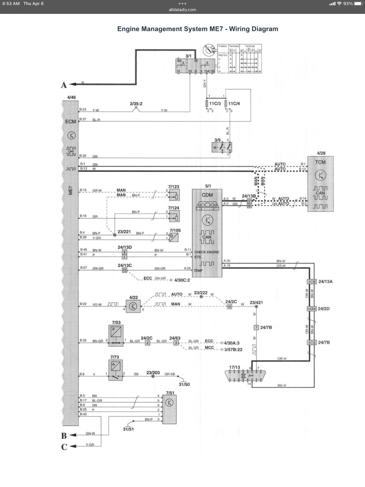

Those codes point to the 7/51 accelerator pedal position sensor but that’s a very rare to fail item. The 7/51 shares a common 12V feed ( green white wire ) with the ETM so it’s worth a check there. See diagrams from VIDA below
I think it’s likely your ETM is generating spurious codes on the accelerator pedal, that has been seen before here.

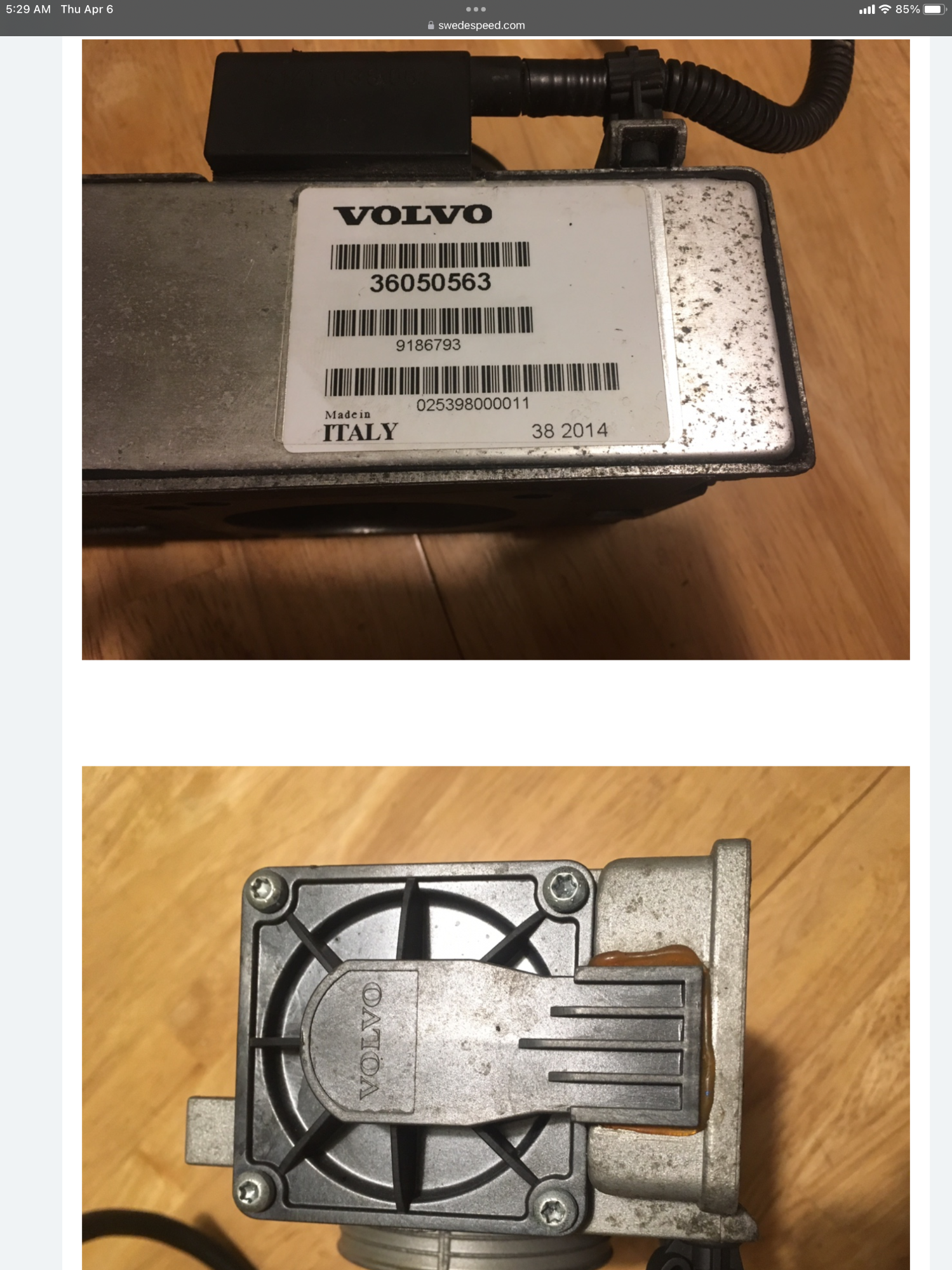

Accelerator pedal sensor part number 30683511 nasty expensive , like $300
Updated ETM contact less part number 36050563
