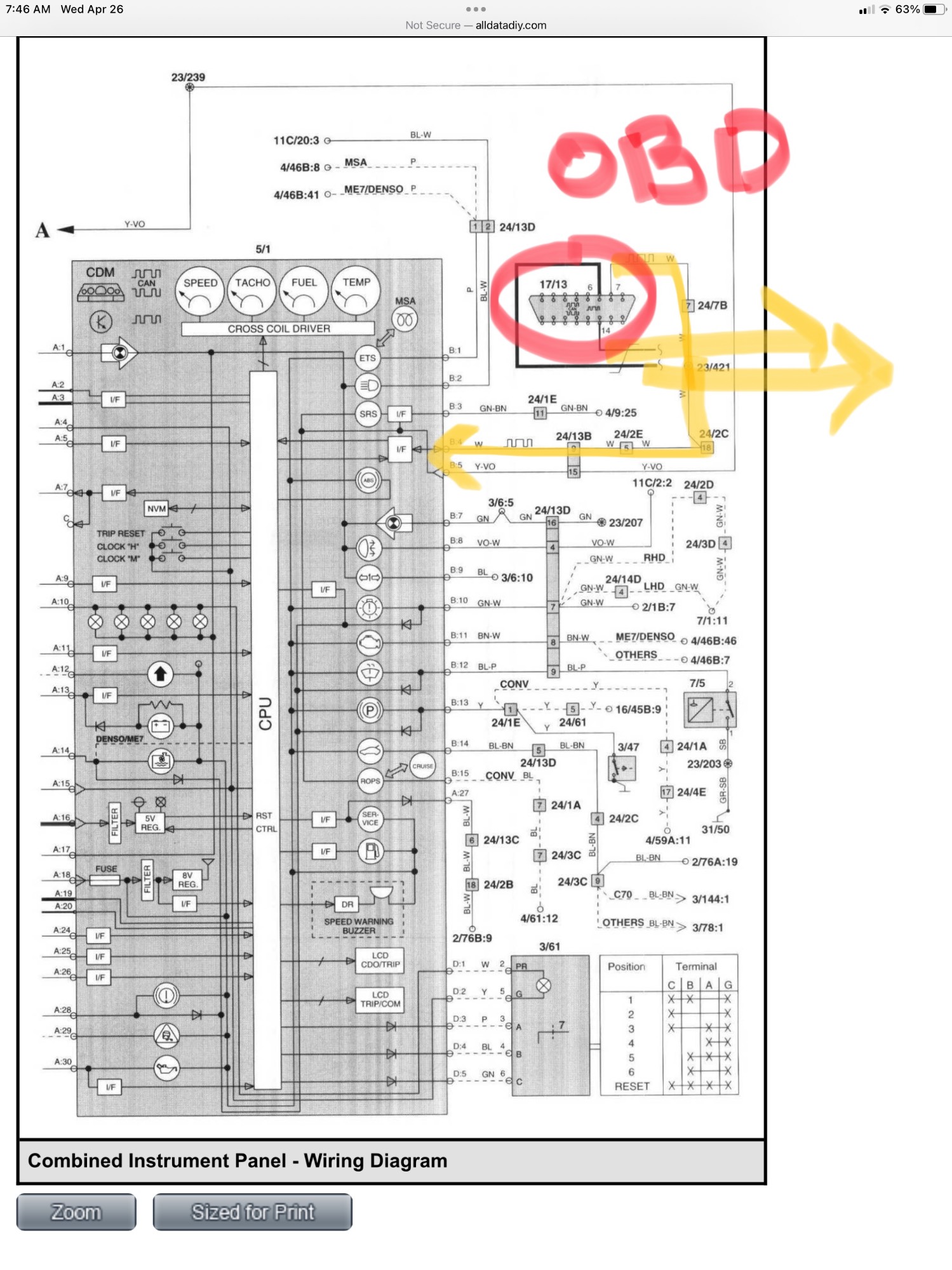

Here is how a 1999 OBD talks to the ECU
IT first goes into the driver instrumentation module or DIM, see yellow lines

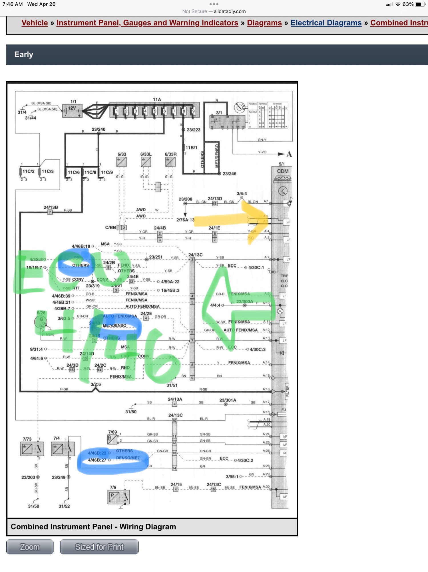

The green lines follow it out into the ECU , module 4/46 by number.
Any wiring fault between these will look like a bad ECU
The DIM to ECU path isn’t as bad as it looks, these diagrams have every option of engine management shown, your car will only have one of these. I tried to label on the DENSO ONES IN BLUE

Much better picture on the engine management side…

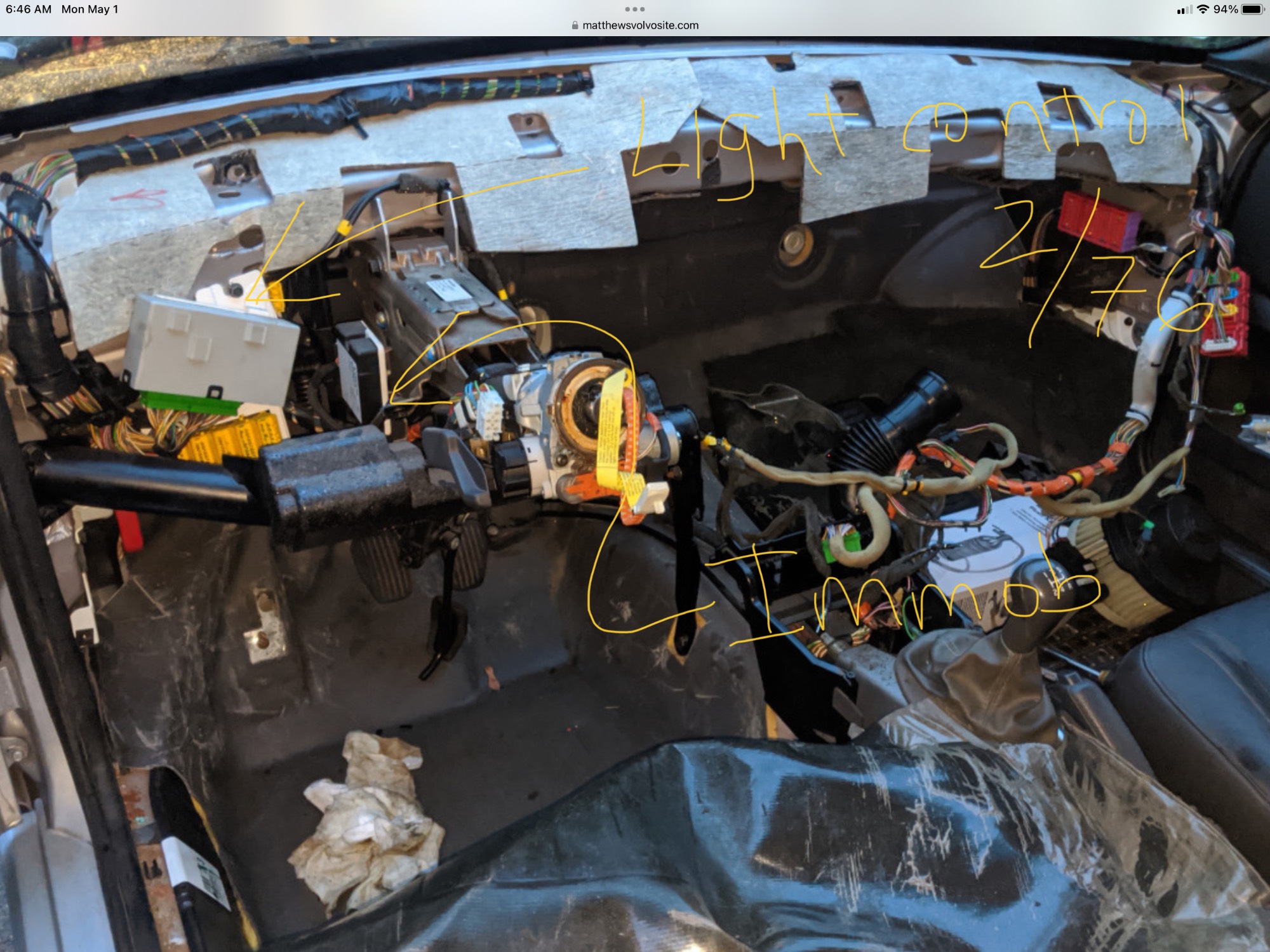

Is the immobilizer unit the small box on the LHS of the steering column or the larger one above the LHS footwell?
https://www.volvovancouverparts.ca/a/Vo ... 70680.html
Is this #2 on the drawing above?

scot850 wrote: 28 Apr 2023, 15:31 Is the immobilizer unit the small box on the LHS of the steering column or the larger one above the LHS footwell?
Yes it is #2 the brain of Immo. Either in Black or Blue colour. Around near steering column.. SV40 models has it way easier on almost next to bonnet leveler. It is secured on 850 extra plastic which need be removed first then you can use flat head screw driver pry it off from metal casing (has bended metal tab holding it other side just -- slides off then but being careful with connector on top not yank too hard).
And as you now mentioned i have once heard loose connector on either antenna or to that #2 box having loose pins which could be checked if not yet.

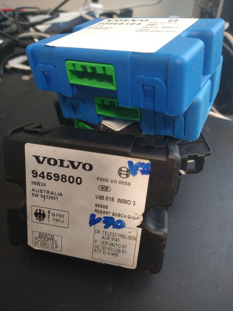

He has a matching set ECU, Immo, Cluster and keys from a 2000 m56 V70. Those parts should slip right in. For testing I could tape the key on the antenna ring and remove the chip out of my key.
