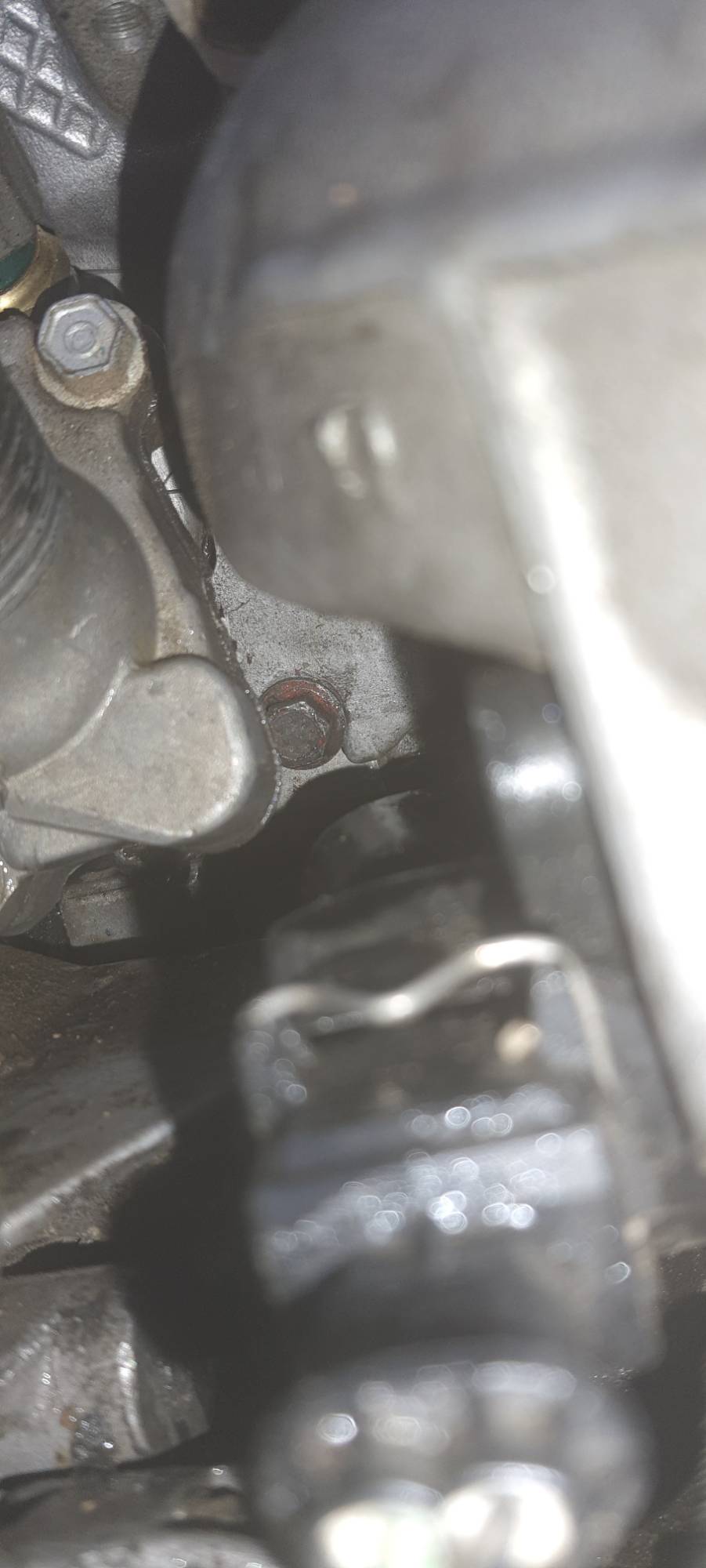

@abscate it sure isn't possible. I tried, the 1/4 is about to strip the head of the bolt, because I cant insert the cup further in. And I really hate mucking with the thermostat housing, I will have to apply a new sealer on it.

Post by vtl »
Your tools selection is poor ;) You need a short socket on a 3/8" U-joint and a variety of extensions. It is actually not that painful with the proper tools.
My arm is also barely long enough to reach that bolt with a wrench under the manifold. PIA, but I did it that way a couple of times.

Post by dikidera »
Under the manifold is my BIFUEL CNG distributor. It's bolted onto it. I am using the same tools though. But my swivel is I guess thicker.
