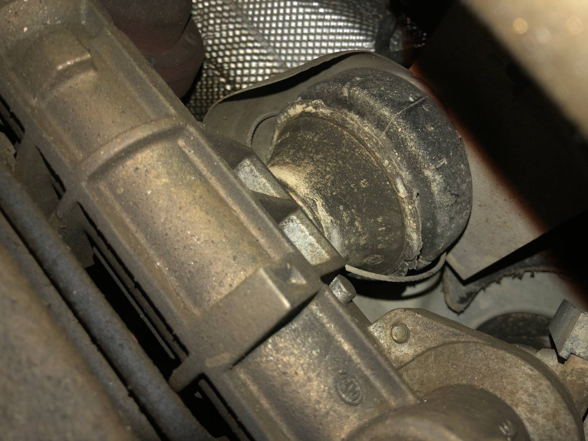

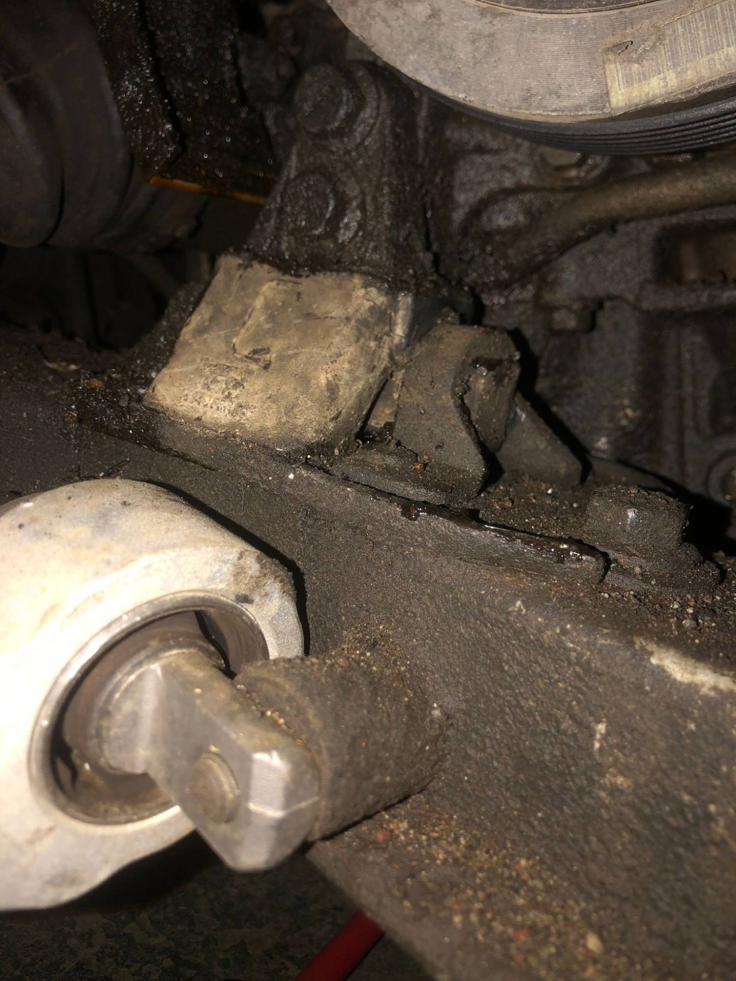

Below is a photo of the lower right engine mount that I took a few months ago. It seems fine with no cracks/tears. In the photo, the engine is being raised a little bit, and looks a little squished without the engine raised.
The torque mount is new, and didnt seem to make any difference even though the rubber was worn.
The upper mount seems loose as shown in the video, but the rubber looks fine.
So by elimination, would that mean one or more of the hydralic mounts have failed? If so, how can I test them?
Engine clunks sometimes when accelerating after braking.

The last mounts that are not confirmed to be good are the hydralic ones. Here are some photos. overall they look fine, but the metal cord around it seems loose. This is fine, right?
What else can cause clunking when shifting gears or in stop and go traffic. I think whatever issue is causing this is also causing vibration when accelerating or driving up hill (i.e high rpms).

I think that wire holds the engine in during an accident. It’s loose by design
That right mount, or engine front mount looks really bad to me and would cause knocking amd other noises.
You can use the FWD mount, the AWD adds a plate under it to lift it a bit. Use the Volvo parts webstore to get your part numbers right

I forgot to mention that I just replaced the lower right mount, and the problem did not go away. The bad mount you were referring to is this one and not the hydralic one, correct?
