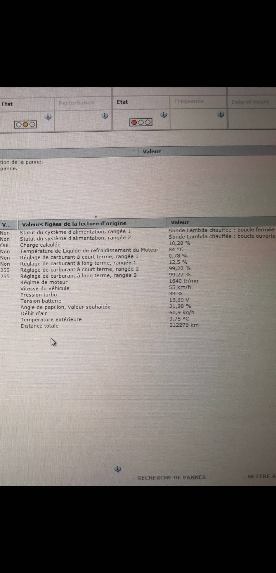

Here are my 02 sensors at idle

Probably the only way is to take it to a repair shop that can test your exhaust emissions. The only other things that may control/test the emissions are the O2 sensors. They will or should throw a code if they are bad.

Front O2 sensor seems to be indicating a perfect running engine. The rear tells another story. One of these two is likely wrong. Which? Well, that's the tough one. If I had to guess I'd say the rear but as scot850 said, if you can have someone test the gases from the exhaust that will tell you which is right, and which is wrong.

How long was the car running when you got these values from the O2 sensors, etc.? If it was at idle and had not been running at say highway or local around town speeds, it could be the front is being set by the computer as a reference voltage until it gets into closed loop mode and that the rear is true since it's a heated sensor.

wizechatmgr wrote: 17 Nov 2023, 06:22 How long was the car running when you got these values from the O2 sensors, etc.? If it was at idle and had not been running at say highway or local around town speeds, it could be the front is being set by the computer as a reference voltage until it gets into closed loop mode and that the rear is true since it's a heated sensor.
The car was juste at starting, idling after 2 3 minutes. I already had driven in traffic jam 1 hour ago.
The problem is I have very limited knowledges about 02 sensor, maybe i'll have to improve this.
Here is the report of Vida at the moment the car threw the 4801 code:
