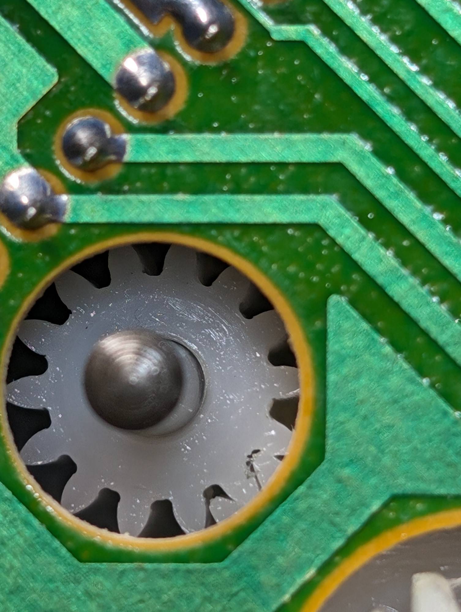

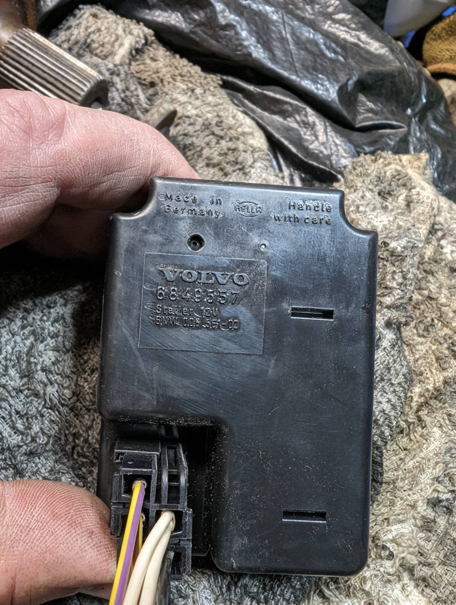

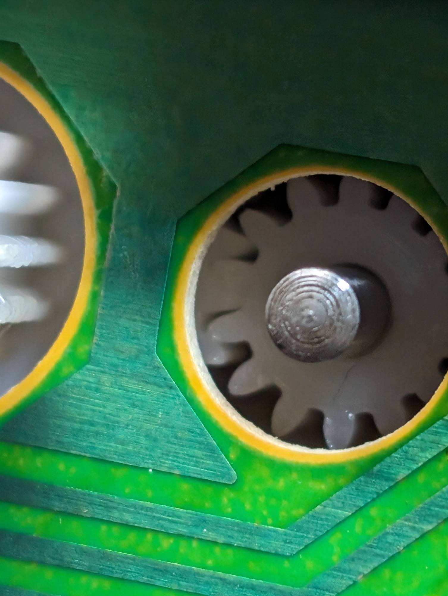

Hi,
Went to the junkyard today, and guess what I found!!
I was amazed when I saw the part number on the case and 5 wire connector (2 are white and go to the same pin).
I opened the casing as I wanted to make sure the gears were still good. What a pain it is to open this unit!
I marked the teeth so I could refit in the same place so I could remove it to try to see the teeth under the circuit board. I did not want to try to remove the board as I could not easily see what was holding it in place. Pictures show at least the small gear under the hole is complete and what I can see of the other seems complete as well.
I will recheck the small gear wheel, as with the enlarged pictures there is what I believe is a hair (I own a dog!) on the wheel that looks like a crack. I will open it and use a magnifier to conform it is good!
I'm assuming this is what you are looking for? If so, PM and we can sort out shipping.

So opened it back up and it was a hair. Thought I got rid of it but can still see part of it. Darn! Anyway, looked under a magnifier and it is sound! That weirdness off where the teeth meet is just grease.

Neil,
That's greater. It is what I am looking for. Thank you so much !! Regarding to the cost + shipping, I am in Boston. So, just give me a price.
