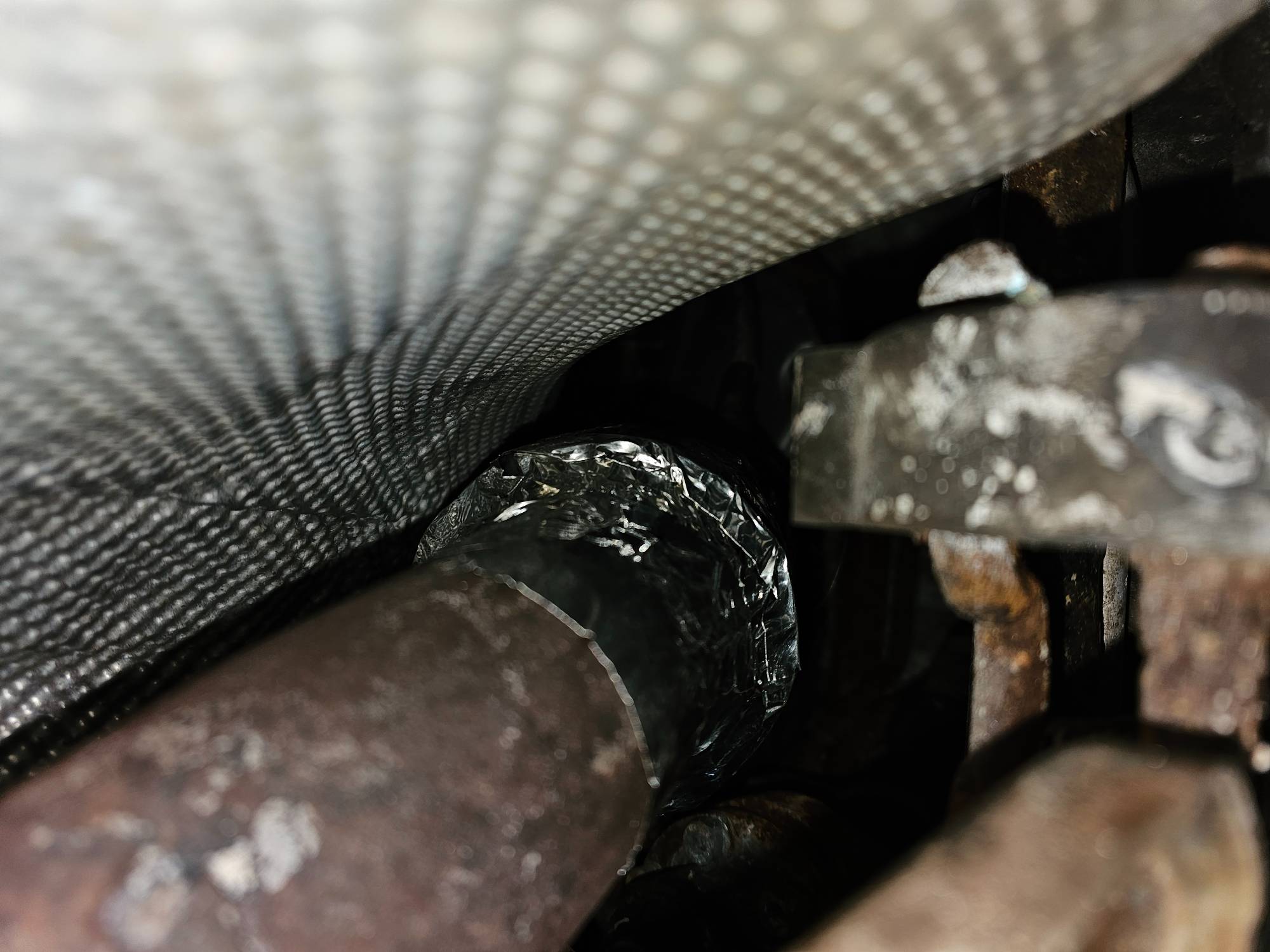

OP here with new info and plan. I removed the metal mesh that covers the flex tube to discover the tube is fine but had completely separated from the pipe leading to the cat. I wrapped this flex/cat joint and tube/pipewith several partially overlapping layers of aluminum tape, redid the cat/resonator flange joint with two gaskets, red high-temp gasket material and jacks to align the surfaces before securing the bolts, and passed inspection. Even with a faint burning smell presumably (hopefully) from the adhesive on the aluminum tape.
Thanks to jonesg for suggestions on both of these joints. Photos and links to materials are below. Unfortunately, don't have photo of wrapped joint but it's just what it sounds like. Aluminum fitting over the contours of the joint and several inches before and after. Edit - photos of wrapped joint now added taken after ~20 miles of mixed city/highway driving.
Obviously only a temporary fix. Seems that a good shop should be able to weld the flex tube to the cat pipe while everything remains in place in the vehicle. No removal, jig for alignment, soldering on the bench or reassembly required. I can then figure out some type of protective covering similar to the original wire mesh.
The cat flange at the resonator interface is corroded away to the point that it needs repair or replacement to truly seal. (A slight leak currently remains.) This should be an easy job for any shop.
I now have a full year for a permanent fix. I'm considering this opportunity to attempt welding. Pretty sure I can handle the cat flange one way or another. The flex tube/cat joint will require "blind" welding of the portion facing the underside of the vehicle. I bet it's doable by a shop if I fail.
In any case, a much simpler and cheaper solution than I feared.
