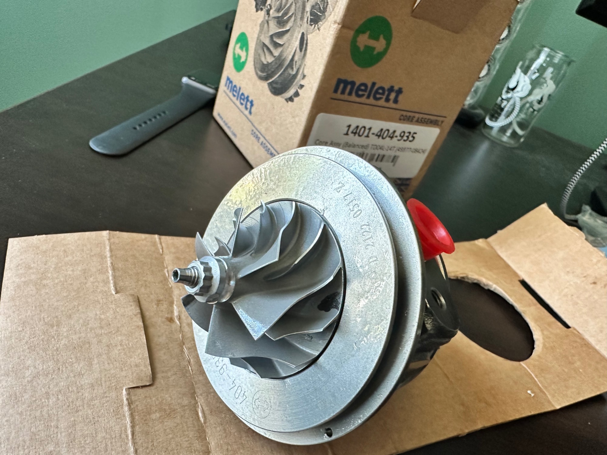

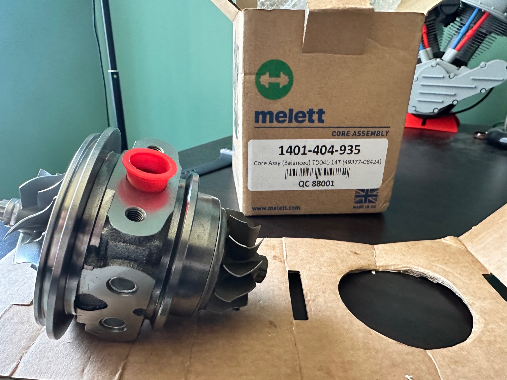

Just wanted to give an update, not hit and run like most people do when asking for repair info.
I’m still in the process of getting parts to do this repair but I just got my CHRA in from the UK this morning.
I ordered direct from Turbo Rebuild Limited’s site in the UK.
It cost me $199 shipped to Illinois instead of $250 on eBay for the same Melett CHRA.
I’m ordering all the other gaskets and lines I might want to replace while I’m in there. Think I’ll start next weekend. I’ll keep you guys updated.

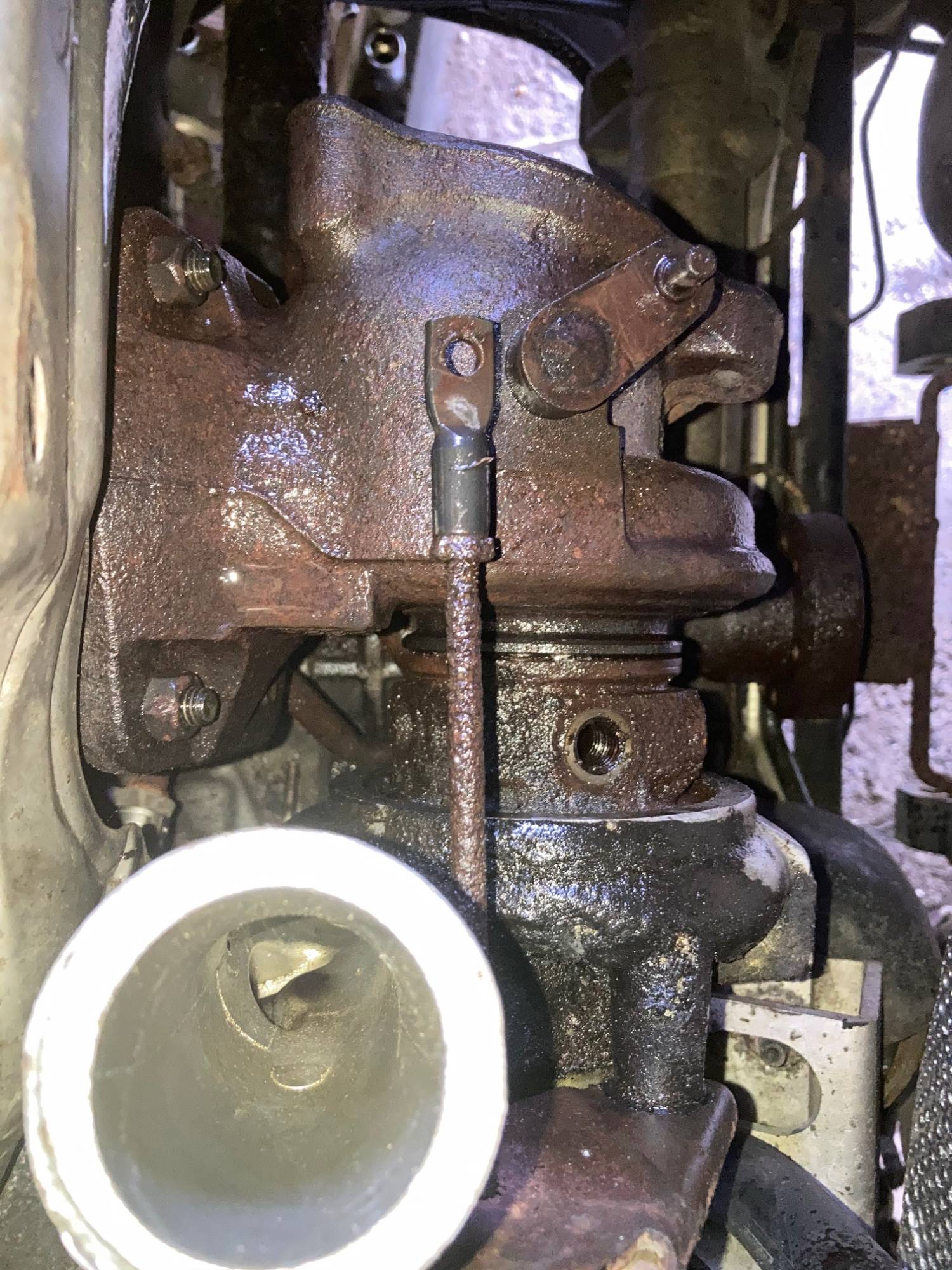

If you don't mind me chiming in. I'm trying to pull the turbo out of a 2006 S60 2.5T AWD.
I've got all three banjo fittings and the drain pipe disconnected. V-band clamp is off. Intake and charge hoses off, and the exhaust was off anyway.
It won't budge.
Have I missed a fastener, or is it likely rusted in place?
It won't budge.

it can't really rust , its cast iron to alum.
possible a bit of oil got baked in the seam, try a dead blow.
the two halves are aligned with a steel pin, mine was snapped, try a knife in the seam between the halves.
also try 2 hands on the front alum section , pull and push up and down to jar it loose.

Hmm, caked oil... ya think?

Even better, that makes it a possible galvanic cell. Mere rust would be less of a PITA.

I've got one. I'm afraid of damaging the turbo. Where should I be whacking it?
Or should I just be assuming I'll have to replace it, at this point?
