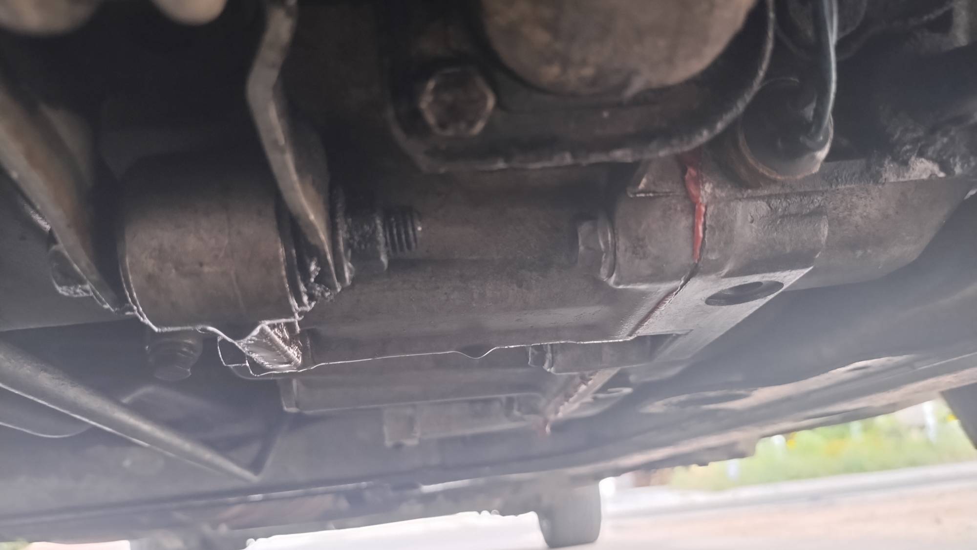

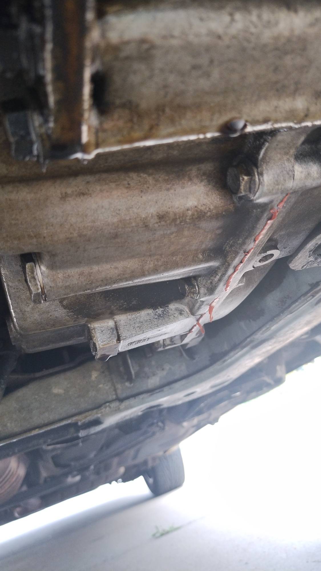

How long, or how to faster, determine if the PCV fix is enough for the RMS leak?
So successfully completed the PCV service yesterday (post link above). Power washed the underside after. These drips showed up this morning after driving a total of 30? Miles yesterday. The freshly oil coated area goes past the second cross member.
Wondering if it might be leftover oil (I don't think so) or what the chances are that atp 205 as suggested above or something could seal the leak.
I'm leaving in 4 days to deliver this car to my kid so would like to do what is doable before leaving.
Thanks

Post by jmartin919 »
In that second picture, the middle bolt of the three on the left is right beside the small opening where the RMS will leak oil out.

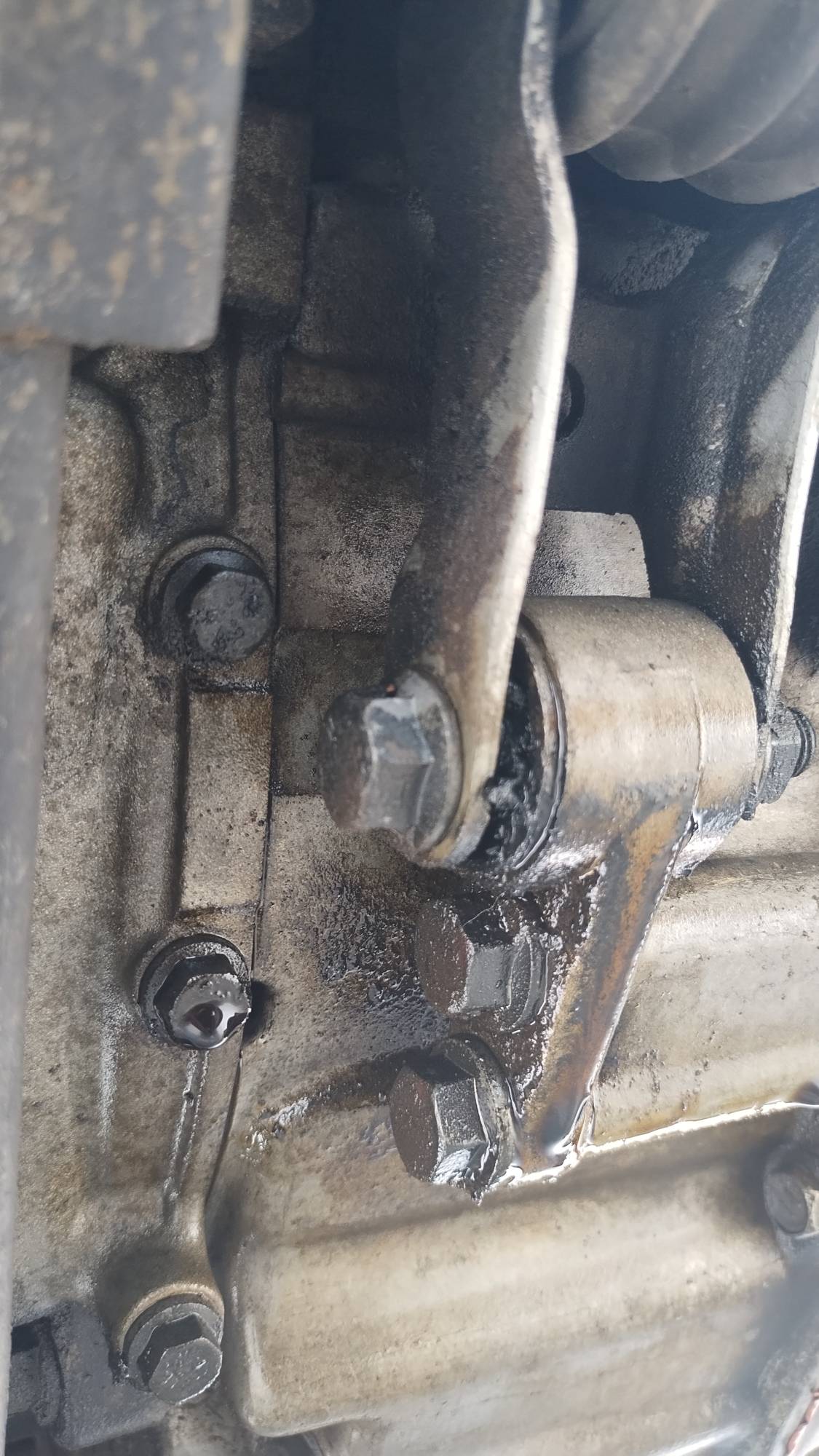

Post by Andrew Vanis »
jmartin919 wrote: 21 Jul 2024, 10:50 In that second picture, the middle bolt of the three on the left is right beside the small opening where the RMS will leak oil out.
If that's the case, it's interesting that that area is relatively dry and most of the oil is on the ridge that the motor mount attaches to. That the ridge is in front of hole also makes one wonder how the oil is getting forward.

If you are getting just a lite drip from that area, it could either be RMS or rear cam seals leaking down.
Just to check, you are not getting any oil leaks at the top of the engine at the spark plug area? Sometimes when the oil filler cap gasket leaks into this area, it eventually drains to the back where there is a drain that leaks out down the back.
If it is possibly the first 2, then I would throw in a bottle of AP-205 or Blue Devil seal conditioner and take the car for a good run. In our case it was Reno to north of Sacaramento. Most of this was done at highway speeds.
Bottom line, a good steady long run. Mileage I would suggest trying 50-100 miles and see how it goes.
Don't throw the seal conditioner in until you are ready to set off.
Good Luck!
