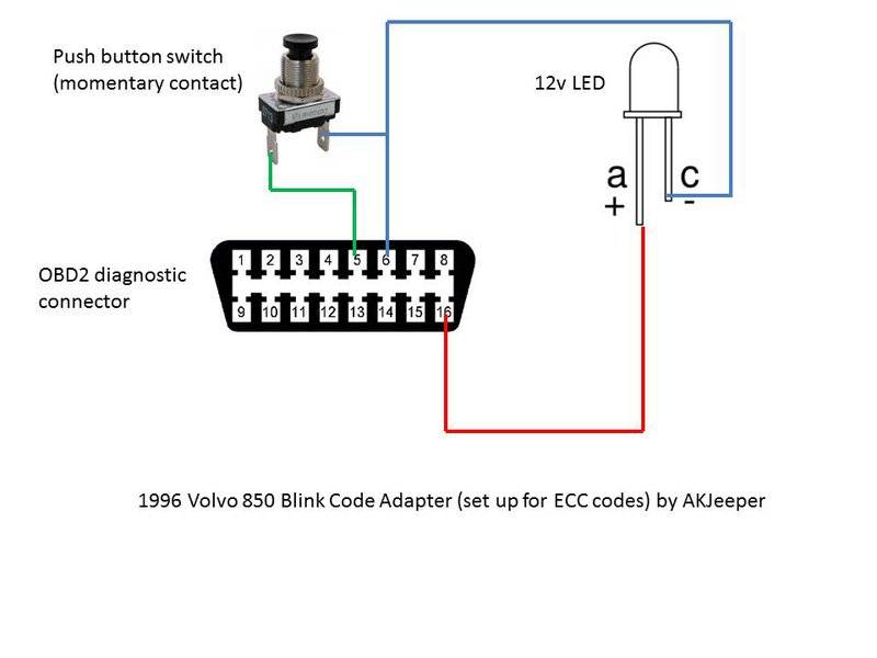

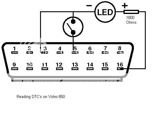

Hi,
I’m trying to figure out how to read the transmission codes and ABS codes. Can you tell me which pins are used for these? Will the app work for reading them, or do I need to use a different method?
I found some pictures online:
Pin 3: Is this for the ECU? Does ECU mean all engine codes?
Pin 6: Is this for the ECC (Electronic Climate Control)?
I also read that:
Pin 7 could be for the Transmission Control Module (TCM), and
Pin 1 might also be for the TCM.
Can you confirm if this is accurate? I want to be sure before proceeding.
Thank you so much for your help!

Yes but i didnt list AC for you.
These ECUs on this list on 850 series models are not behind OBDII port for ELM interface to be readen.
-Motronic M4.3
-MFI system (LH-jetronic 3.2 & EZ129K)
-Fenix 5.2
-ECC(A/C)
-Cruise Control
All others which are not listed ECUs App can read and clear fault codes on 850 models.

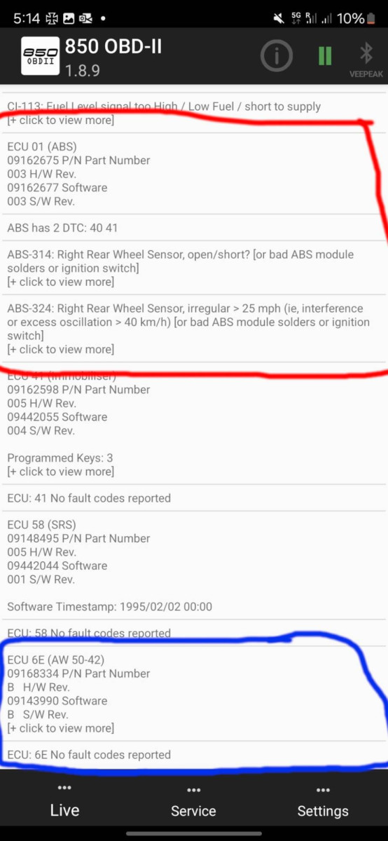

For below later your question.. ABS and TCM aka Gearbox aka Transmission code readen.. what you have in mind as you have readen them in screenshots?
Pin #3 is ECM (ECM aka Engine Control Module - I call in the car all electronic modules as ECUs as its more used these days call them all as Electronic Control Unit)
Red is circled ABS and its two fault codes and their descriptions
Blue is TCM / Gearbox / Transmission and it says No Fault codes reported.. so it doesnt have any fault codes.
AW50-42 is type of Gearbox what was used on 850 and 70 series and Volvo didnt yet these days used term "TCM" which why its named like how Volvo did on their own Service Tool as well. Since 99 year model 70 series Volvo did upgrade their Service tools to call AW50-42 aka Transmission as TCM so thats why it changes in App too for those models as "TCM".

Here’s an improved version of your message:
Thanks for the help! I was able to clear the codes, and the fuel code is now gone—only the ABS code remains, which I’ll check out later. I’ve decided to keep the app and device since they’re useful for reading most systems.
However, for engine codes, it seems the only option is using the DIY LED light method (as shown in the attached image), right? That’s my top priority right now, especially since I’m dealing with a clogged PCV system and had previous misfire issues.
Let me know if I’m on the right track. Thanks again!
(Check attached picture) :D

* pin 1 -- EZ 116K Ignition (for 900 and S90/V90)
* pin 3 -- Motronic 4.3 (for Volvo 850 T5?)
* pin 3 -- Fenix 5.2 (for Volvo 10 Valve 850 and ?70)
* pin 3 -- Jetronic LH 2.4 (for Volvo 900 and S90/V90)
* pin 6 -- Climate Control (for Volvo 850)
* pin 12 -- ABS (for Volvo 900 and S90/V90)
* pin 13 -- Cruise Control (for Volvo 850 and other models)
Yes picture lights are correct.. the thing is just switch grounds connection momentarily to give signal and then ECU will return with GND so LED lights up and how ECU pulses the GND in return which you see as LED blinking.
P.S. I suggest not Grounding Pin #7 as its shared connection.
P.S.S Sorry of confusion as i didnt first catch that AW50-42 name as what it meant was lost in translation previously.
Thank you so much.
Pin #7? You mean Pin #5? but everyone says to do it like that;
https://www.volvoforums.org.uk/showthread.php?t=83895
I don't want to burn my ECU.. :cry:

BeerDeer wrote: 12 Dec 2024, 07:11
xanthefin wrote: 12 Dec 2024, 06:36 * pin 1 -- EZ 116K Ignition (for 900 and S90/V90)
Thank you so much.
Yes use Pin # 5 for Ground for your led flasher diagnostic tester.
I did mean shortly not put the wire in Pin # 7 at all like you thought in previous messages once as an option (not to push that pin to ground i meant as there is communication between modules too)
This message i mean: Pin 7 could be for the Transmission Control Module (TCM) :wink:
ECUs has some level protection against shorts and accidental +12V feed but i feel like not to test them unnecessarily.

Thank you for your kindness. I will report back with any errors! :)
