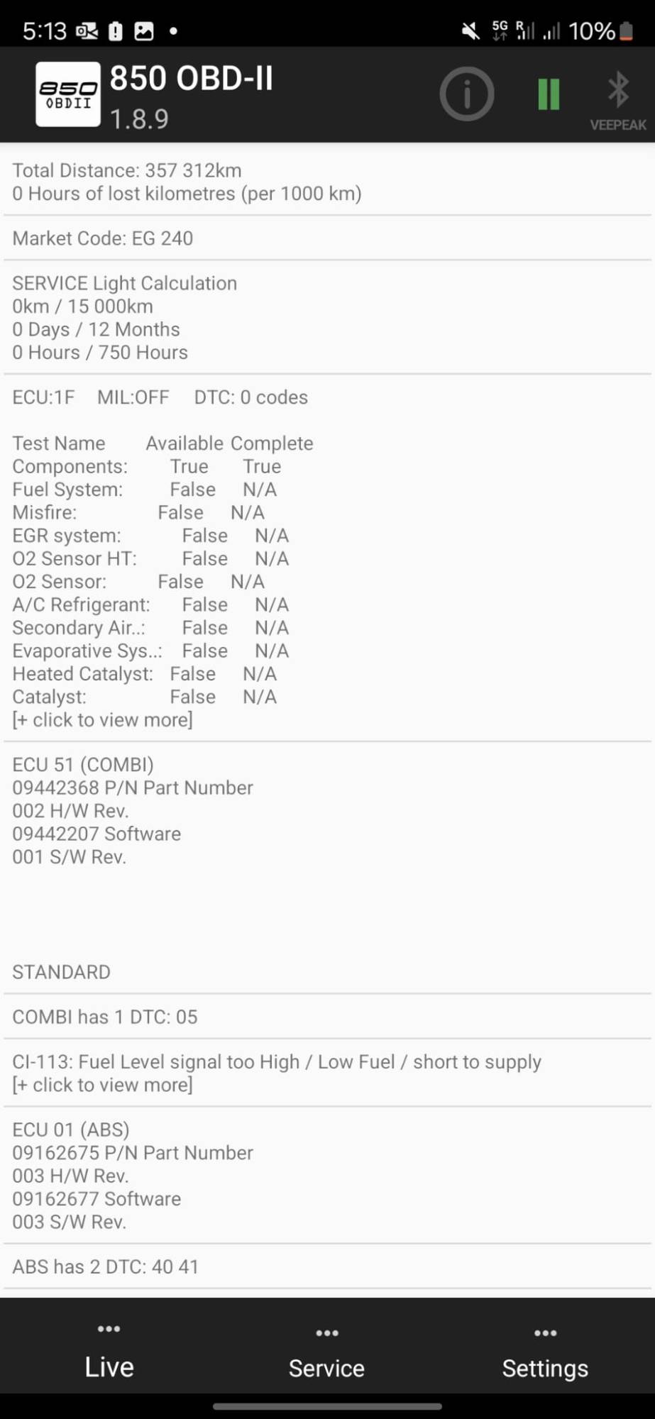

Hi,
As you know, I’ve been reaching out frequently over the past few weeks regarding my car issues. :( :( :(
Thankfully, I’m making progress! I recently received my Veepeak OBDCheck BLE+ Bluetooth OBD II EOBD Diagnostic Device Adapter, which I’m using with the 850 OBD-II app (I believe this is the correct one, right?).
Initially, I had trouble connecting via OBD-II and Motronic 4.4, so I switched to COMBI, which seemed to work.

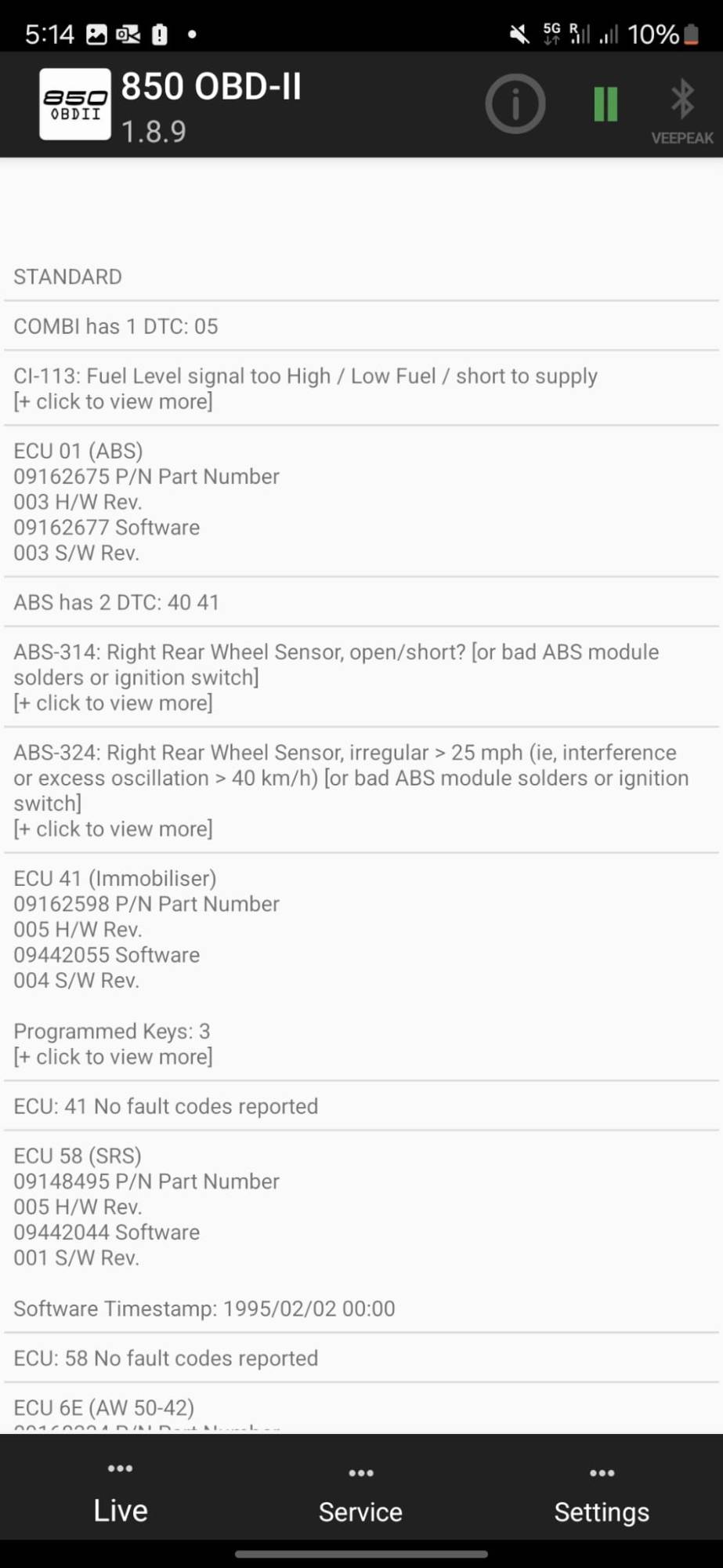

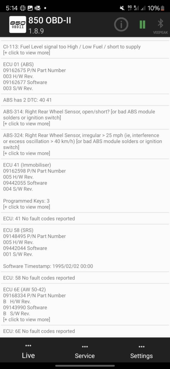

I’ve scanned for codes, and here’s the output. Could you take a look and let me know if anything seems wrong? Should I clear the codes and rescan for accuracy, or is this good for analysis?
Thank you in advance for your help!

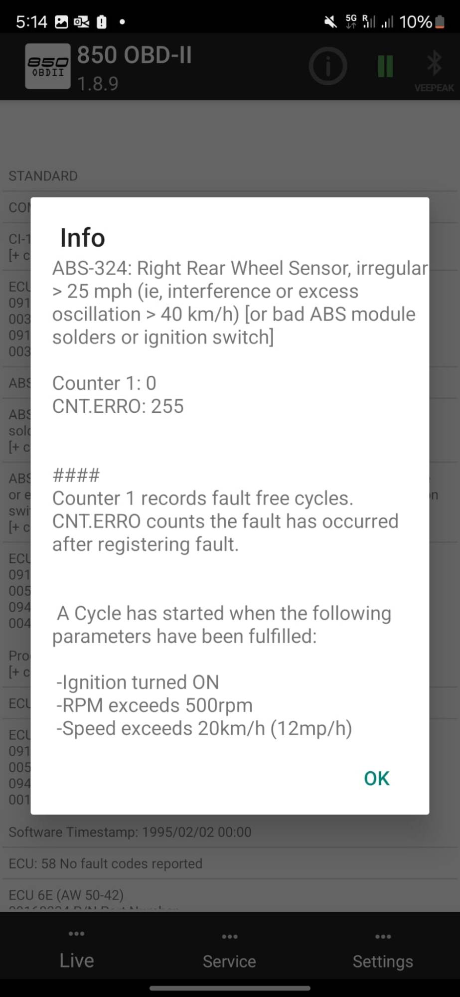

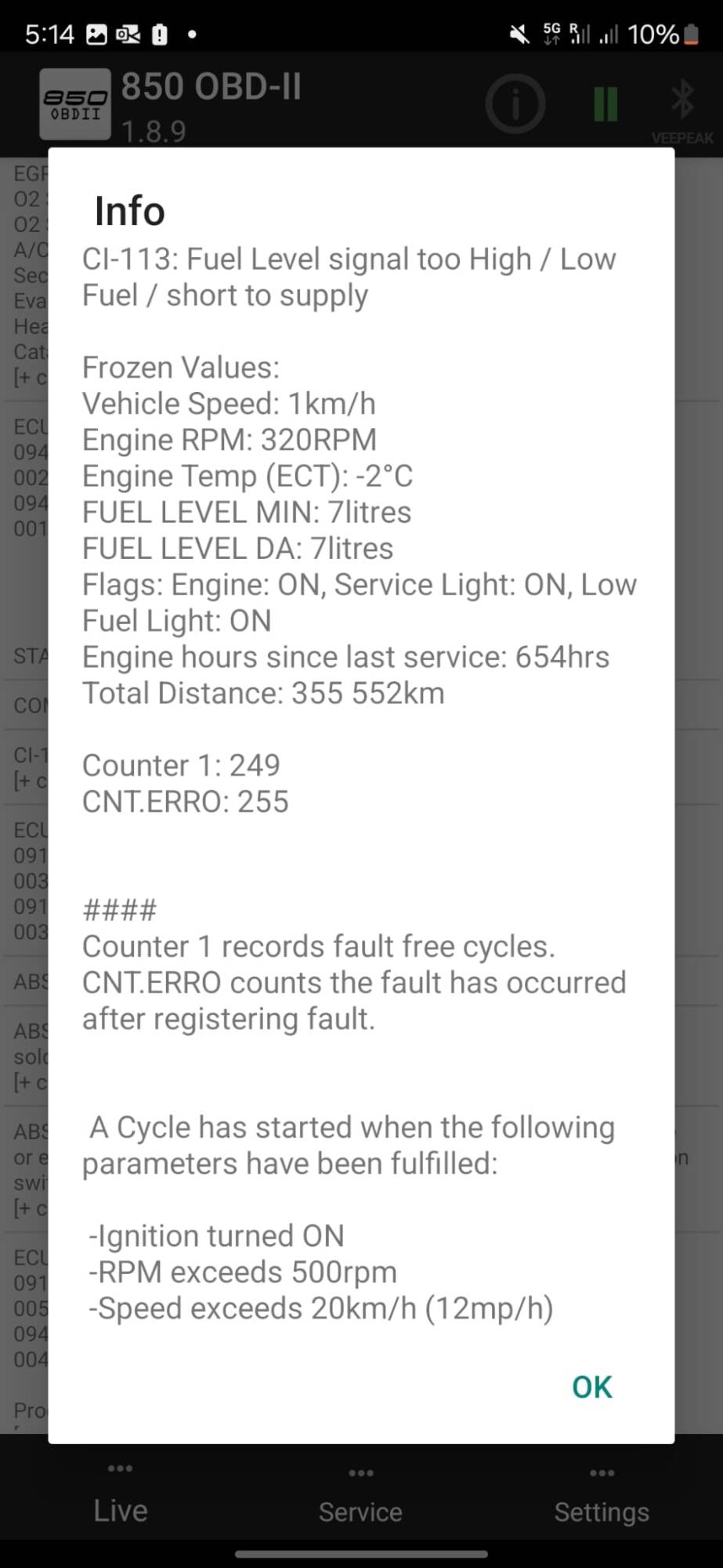

Am I understanding right?
Fuel Level Signal (CI-113): Persistent fuel sensor or wiring problem. (Was it because I disconnected MAF to clean it?)
ABS-314 and ABS-324: Problems with the right rear wheel ABS sensor or related circuitry.
Its Fault Free Counter (249) is almost 255 where it clears automatically code then and vanishes by itself. So its not active code only happened by looking FreezeFrame 2 thousand km ago.
If Standard OBD wasnt connected then i dont wait there being a Motronic M4.4 and more likely M4.3 but can confirm the from the label under the hood the ECM type when know Part Number.
The Standard OBDII from Scan is if i can guess by looking ECU address 1F and what it supports just Transmission answering.

Hi, App doesnt support M4.3 Engine ECU sorry. You need leave that option out.
On 850 models you can see information (Fault Codes, Live Data) / Read Codes / *Trigger Device testings and *Program parameters via OBDII from these ECUs
Motronic M4.4*
MSA15.7*
AW50-42 (Automatic Gearbox)*
ABS*
SRS (Airbag)
COMBI (VDO dashboard)*
Front Electric Seats*
IMMO*
Transmission it does as you seen from Summary view its there readen and no codes. So to read fault codes is from Service >> Scan (and select ECUs you have on car | Selection viewavle ECUs Default is "All" and then some models and years of Volvos but example next update there will be too 850 Series selection to limit out 70 series ECUs like VGLA, ECC etc..) it says these days below it if ECU had codes or no codes in same view. Example in Screenshots ECU 58 (SRS) -- Module information -- and next there below is "ECU: 58 No fault codes reported".
Then next ECU 6E (AW 50-42) [This is Transmission] -- and below again ECU: 6E No fault codes reported.. So gearbox doesnt have fault codes.
Only old - not anymore produced for decades - Volvo System Tester which Volvo used internally and their dealerships do in full length support (additionally to ex. led light way to read codes via OBDII port pin #3 it only supports Live Data) M4.3 as it uses older Volvo diagnostics system protocol but it has a side protocol which is just led light and switch system to read it which older 850 models ( pre 96 ) had own diagnostic box under bonnet to read codes.
The system you looking for costs anything between 300 EUR to here if you even manage find one from market used.

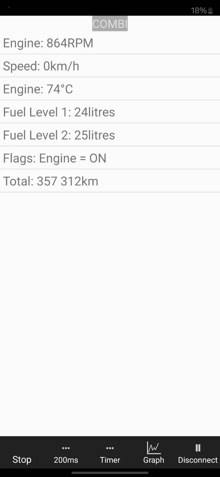

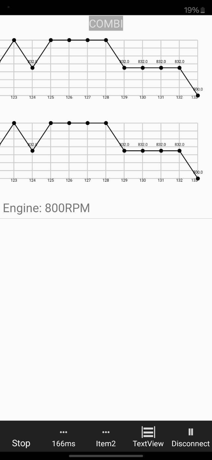

Today, I managed to read and scan codes using the OBD-II app and device again. However, I noticed some limitations:
- I can’t access live OBD-II data, but I can view live data when using the COMBI option.
