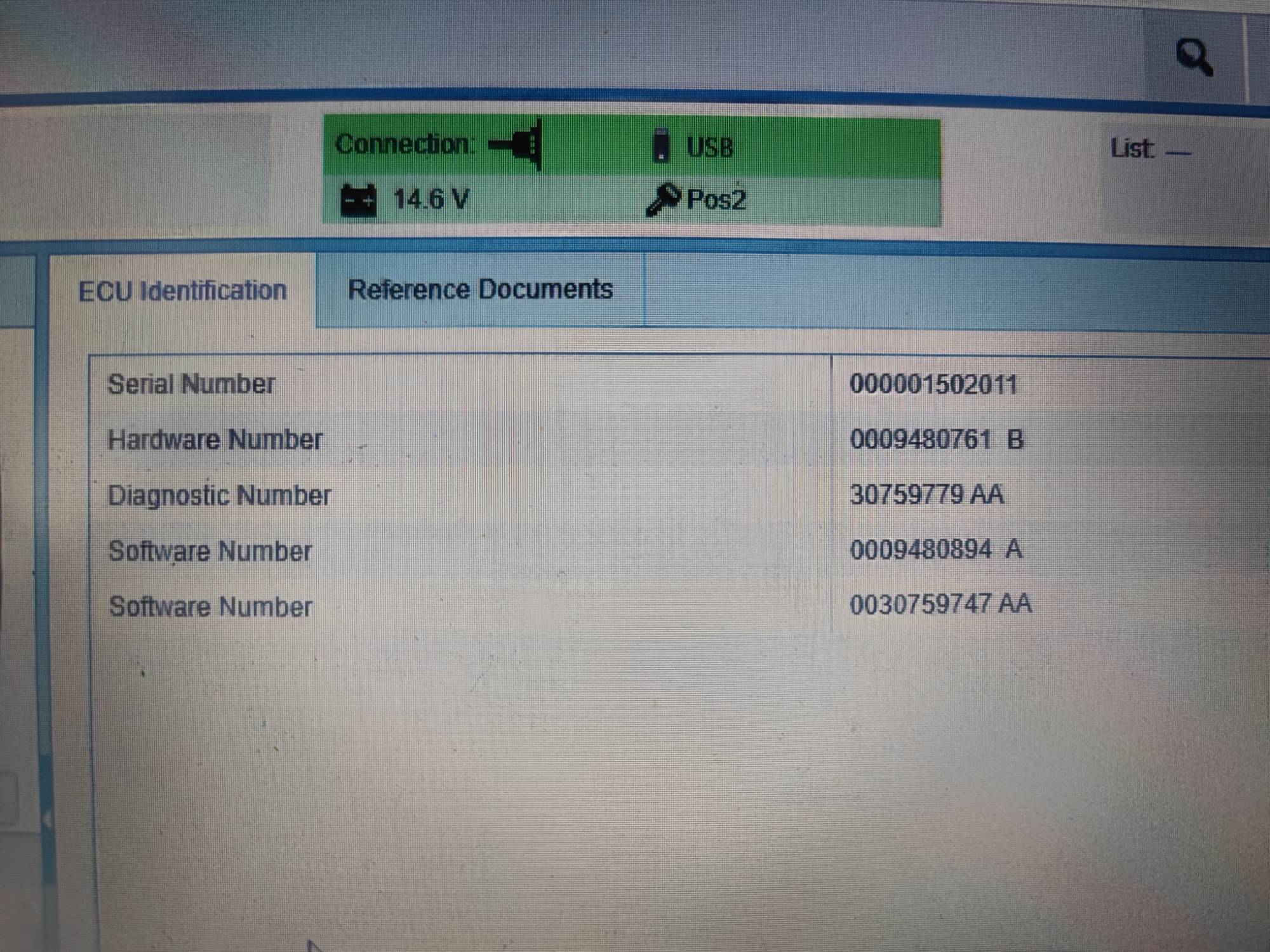

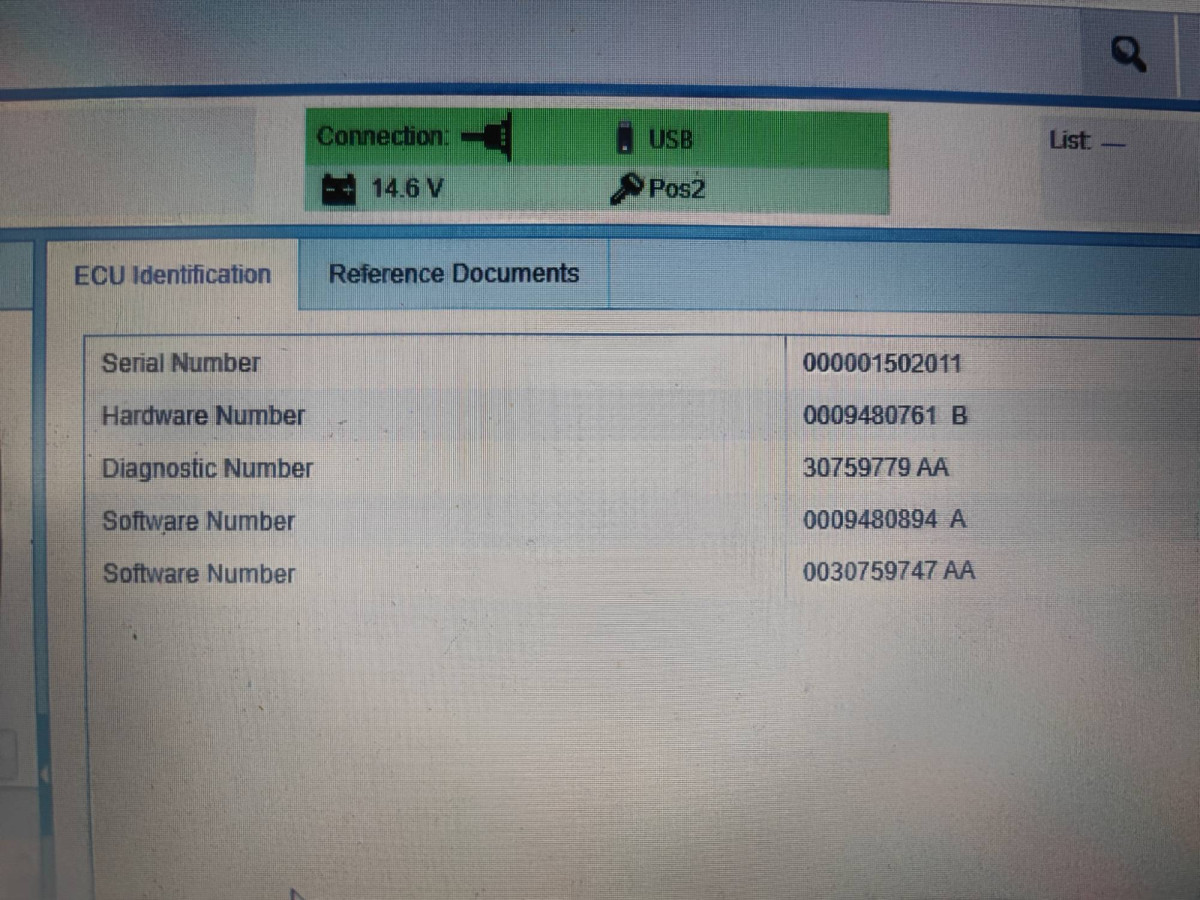

Ahahaha sorry vtl, so much drama for me I totally forgot.
Is this what you need?
