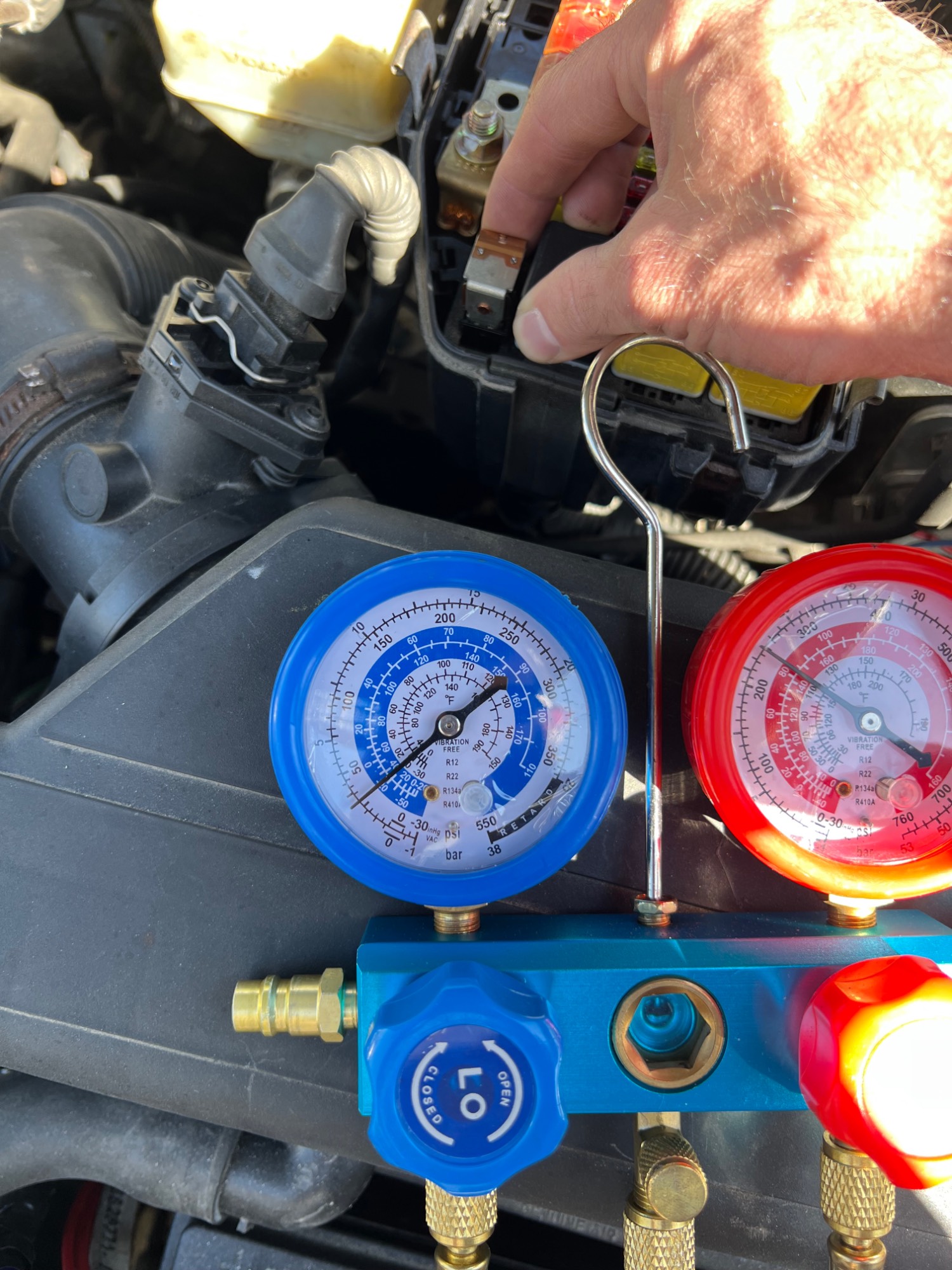

This is me jumping the compressor and the low pressure reading I get when I do so. I get 30 psi. Ambient temp 70 but also parked in the sun. (I removed the top of the relay so I could squeeze the copper part and jump the compressor). Also ignore the red gage. That is obviously not hooked up. ![Image]()
