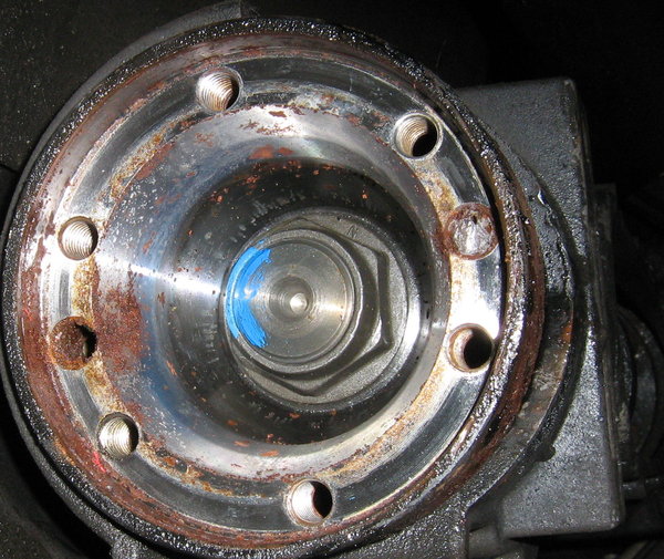

There really isn't anything open at the bevel gear and VC, just a flange and a large nut. Leaving it as is doesn't leave either the bevel gear or VC open to the elements. I'm attaching pictures of the VC end (first) and the bevel gear end. I suppose the flanges might rust a little after some time.brick8 wrote:Hate to revive an old post, but I was wondering if anyone has an answer to the question, is it ok to leave the mounting points at the end of the bevel gear and the VC exposed after removing the rear driveshaft?
