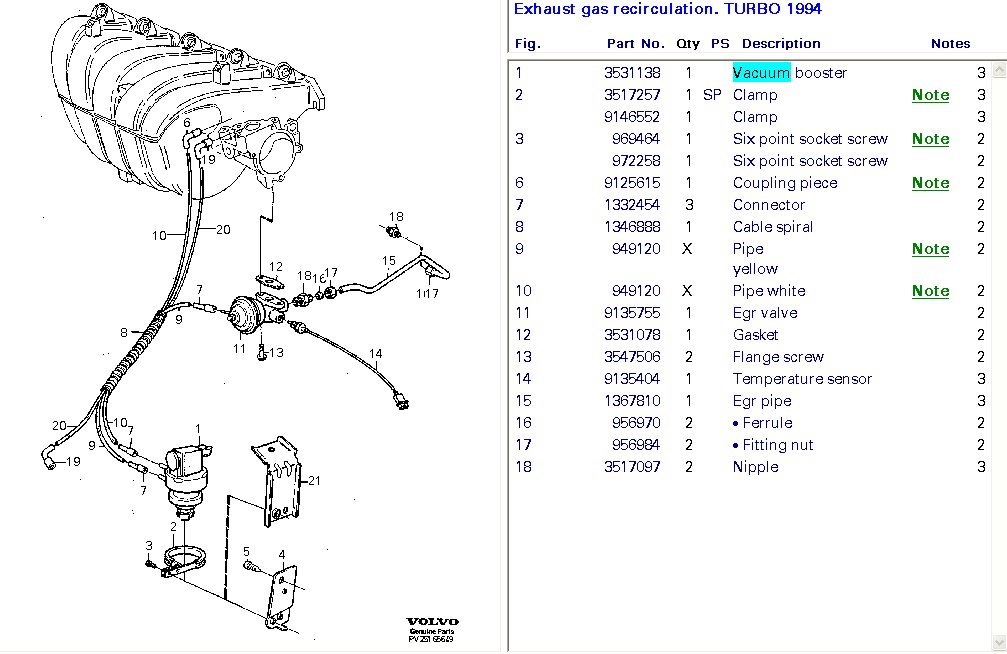

MIJ, I do have an EGR, but a hose already runs to it off the vacuum tree; I wonder if anyone would have a diagram they could post for this vacuum tree. I simply couldn't locate a vacant nipple anywhere or place to attach the missing hose.

Not sure if any of this will help but here goes:
850 Intake and exhaust system.pdf
(112.82 KiB) Downloaded 217 times
EGR System.jpg (109.51 KiB) Viewed 1045 times

MIJ; or anyone who might know for sure... in the last attachment you posted (or the bottom one; depending on how you look at it) where does the #19 elbow attach too (it is the #20 pipe)? The diagram doesn't show, that's the one I'm trying to figure out.

Should attach to the vacuum tree on upper end and I believe a solenoid on the lower end attached to the fan shroud...but I'm not for certain. I suppose I could go look at our 850 w/ EGR... but my son has it out right now and won't be home for awhile.
On second thought you're talking about a turbo car so you don't have an EGR, right? I'm getting confused as so many of these cars have similar routing (the large diagram on the 1st page is for a turbo) but are just slightly different...if you're looking at #19 going from the tree (on top) to elsewhere and it's not related to the EGR at all, it could be hooking up to the EVAP line...there should be a one way (possibly white and black) valve before attaching to a this sort of white plastic looking line that goes to the EVAP solenoid closer to the driver's side...almost in front of the battery under the fan/radiator shroud.

MIJ - I do have an EGR - it connects to the vacuum tree. I ordered and have picked-up a new vacuum tree, it also came with the third nipple as mine does (only mine has a screw in it).
The volvo tech. at the dealer seemed a little stumped and I'm pretty sure he hasn't seen a 90's Volvo in quite sometime from his response.
I simply can't find any hoses or anything that should attach to that nipple for my car. I'm going to cap the new one to ensure no atmospheric pressure games.
