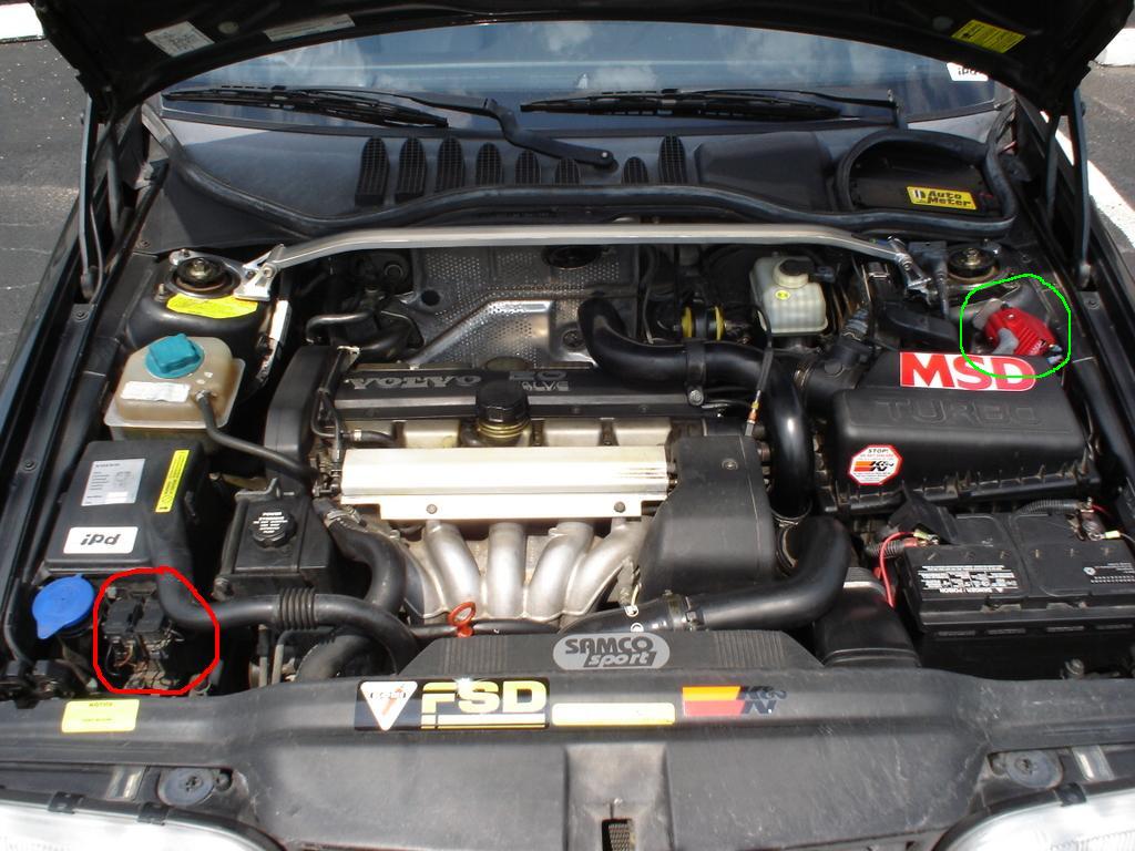

If you have no spark then i suppose that your ignition coil is bad.It is located at right side of engine compartment.On this picture it's circled in green:
This could not looks like yours because this is upgraded/modified one,but they are in the same place.

I checked the ignition coil and there is spark. As a matter of fact I attempted another start but i decided to clean the MAF sensor again and it started for like 3 seconds and then died again. I decided to see if any codes came on again so i checked A2 which yielded nothing ( 1-1-1) and A6, same result. But when I did A7 it gave me 1-2-2, which is saying "Fuel gauge sender unit open circuit" and 1-1-3, " Temprature signal interval too long". What does it all mean?
