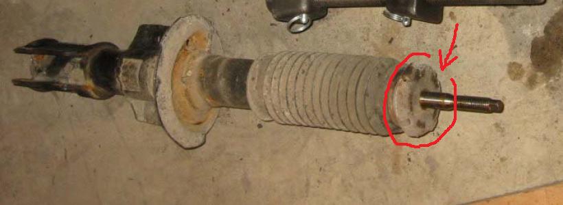

voltech1 wrote:Also, for the creaks it is the springs rubbing on the struts. Spring isolators are available (dealer) that go between the strut and spring. This cures all the little creaks and groans. They call them seats but they are not to be confused with the tops.
Voltech - spring isolators that aren't the springs seats, you've lost me there. Are you referring to the orange sponge isolator that wraps around the strut? see the picture attached.
