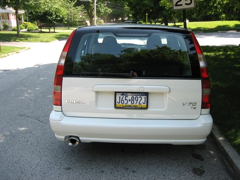

I just installed the EST exhaust
Well made, sounds nice, looks good
