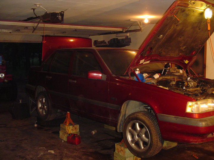

It's been a ~7 month long ordeal, between killing the original motor, disassembly, diagnosis, locating a "new" motor, getting the motor shipped, pulling the car apart, putting the new motor in the dead ones place, and finally last night it started :D 8) .
I say 7 months, it didn't take me that long of actual wrenching time, I tend to procrastinate. If I were to have everything together at once, and were motivated the project could be done in 3 or 4 days by the average shade tree mechanic.
I'm 97% done with the engine swap. I'm still dealing with some of the head/intake differences between my original motor and my new but older motor. I've got to get the hose from the oil separator to the flame trap to be about 4" longer and make an S bend. I've got to make another vacuum line about 3" longer as well. I sealed off the tube coming out of the head by cutting it off and crimping it shut, and had to drill and tap the intake for another vacuum line as I pictured above, but other than that, I don't forsee any major issues with using the "different" motor (knocks on wood).
I've got to get a new radiator, I ripped one of the transmission cooler lines out of the radiator when lowering the motor from the car :x . I just bought an axillary tans cooler from Summit, and patched the hole in the plastic tank on the radiator to get me going for the time being.
So putting a heater hose on, filling it with coolant, bleeding the brakes, dropping it off the jack stands, and she should be on the road again by the weekend (knocks on wood yet again).

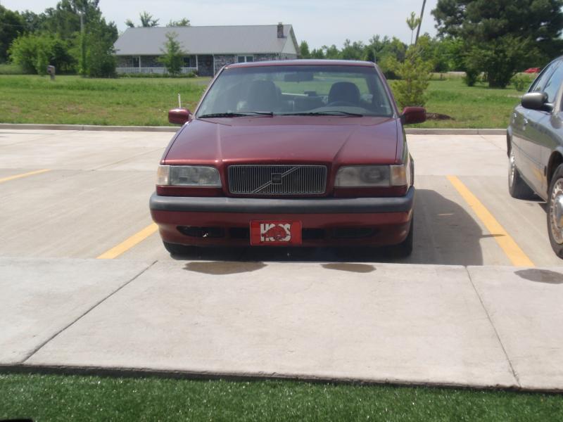

Looky what I drove to work this morning 8) .
New reservoir cap, thermostat housing, and radiator last night. Put a bottle of Marvel Mystery Oil in the tank, drove it to the gas station to top the tank off with fresh gas, and ran her through the car wash last night. Of course it rained over night, but I don't care she needed a bath bad.
I decided to keep the auxiliary transmission cooler instead of plumbing the transmission lines into the new radiator, this also kept me from having to spend any more $$$ on transmission cooler hoses. Plus the auxiliary cooler will do a better job than the in radiator cooler. Since I intend to put a hitch on the car, this will keep the transmission much happier when towing.
If it turns out my "extra" wires on the A/C compressor don't actually go anywhere, I'll charge the A/C system, put the front air dam/splash shield back on, and have a reliable and economical daily driver again.
