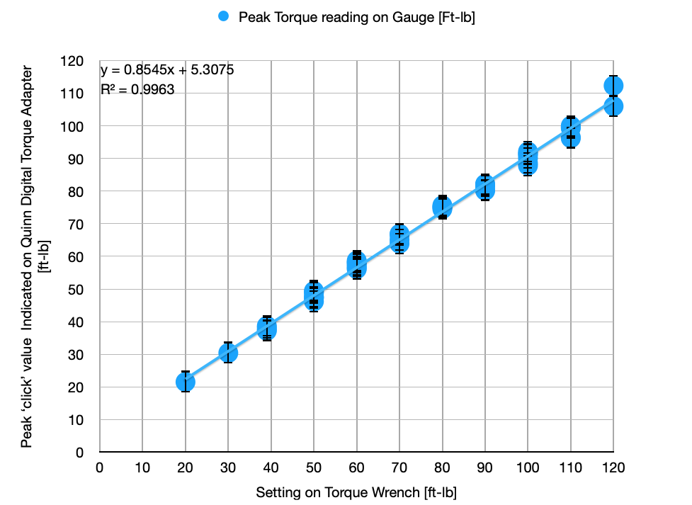

Here's the data for the 1/2" wrench. It was off by 10% (on the low side) at full scale.

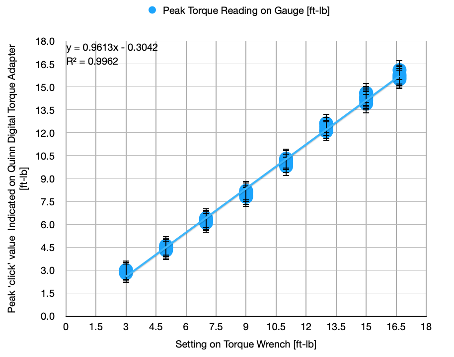

I also measured my 1/4" drive wrench. It was closer, but read 6% on the low side at full scale.
So far, I'm happy with the digital torque adapter from Harbor Freight and I'd recommend it to anybody here who has old torque wrenches like me. I noticed that the fits to all the data were >99%, indicating that the digital gauge and torque wrenches are pretty linear, which is good. But the digital gauge is indicating that the 1/2" and 1/4" drive torque wrenches are outside their 4% calibration spec, both on the low side. The 3/8" wrench was at the 4% limit on the high side. I plan on using the digital torque adapter instead of relying only on the click from the torque wrench.
