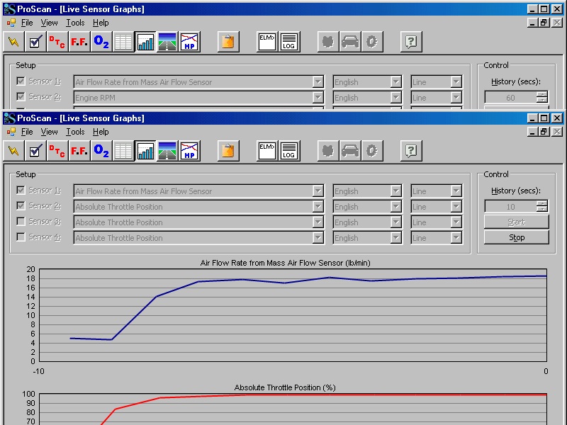

Today I logged actual throttle vs MAF reading. Looking at this, I'm either missing air\boost for some reason or the MAF is borked.

Did some research and 20Lb/min isn't all that bad it seems, translates into 200BHP depending on where you look....this was all around 2500-3000 RPM too. Did the same test in the T5 and it peaked at 22Lb/min, but it hauled of course as opposed to the T6 which slows down with engine compression. For now I'm ruling air supply out.
Fuel or ignition is all thats left. I can't see an ignition problem manifesting itself on a Coil On Plug motor on all the cylinders at the same time without some sort of rough running.
So on to fuel pressure I guess, starts better from cold if I hold the gas down. Also, from memory the car started up when the fuel tank got low, might be a clogged filter, that would be nice.....have to see if I can get my greasy mits on a fuel pressure gauge.
