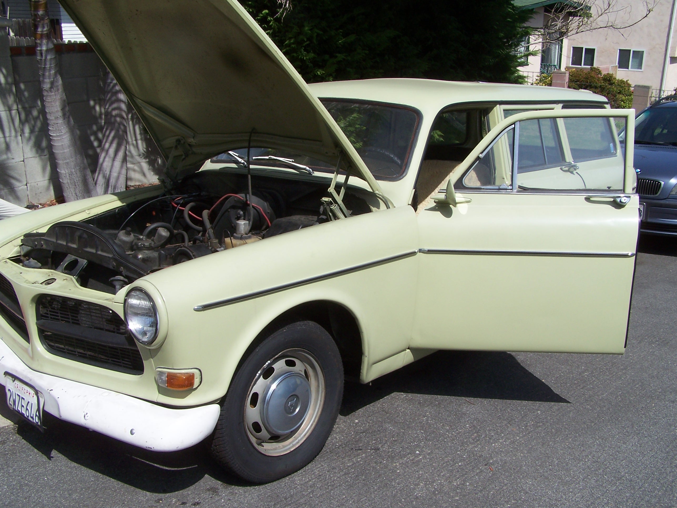

Need help reviving a 67 wagon
I found a cheap pressure bleeder locally. I will attempt to clean out the lines on Sat. I also have an air compressor that has a rubber-tipped attachment on the blower nozzle. I think I will be able to force out all the old fluid/stuff in the lines. Thanks again!

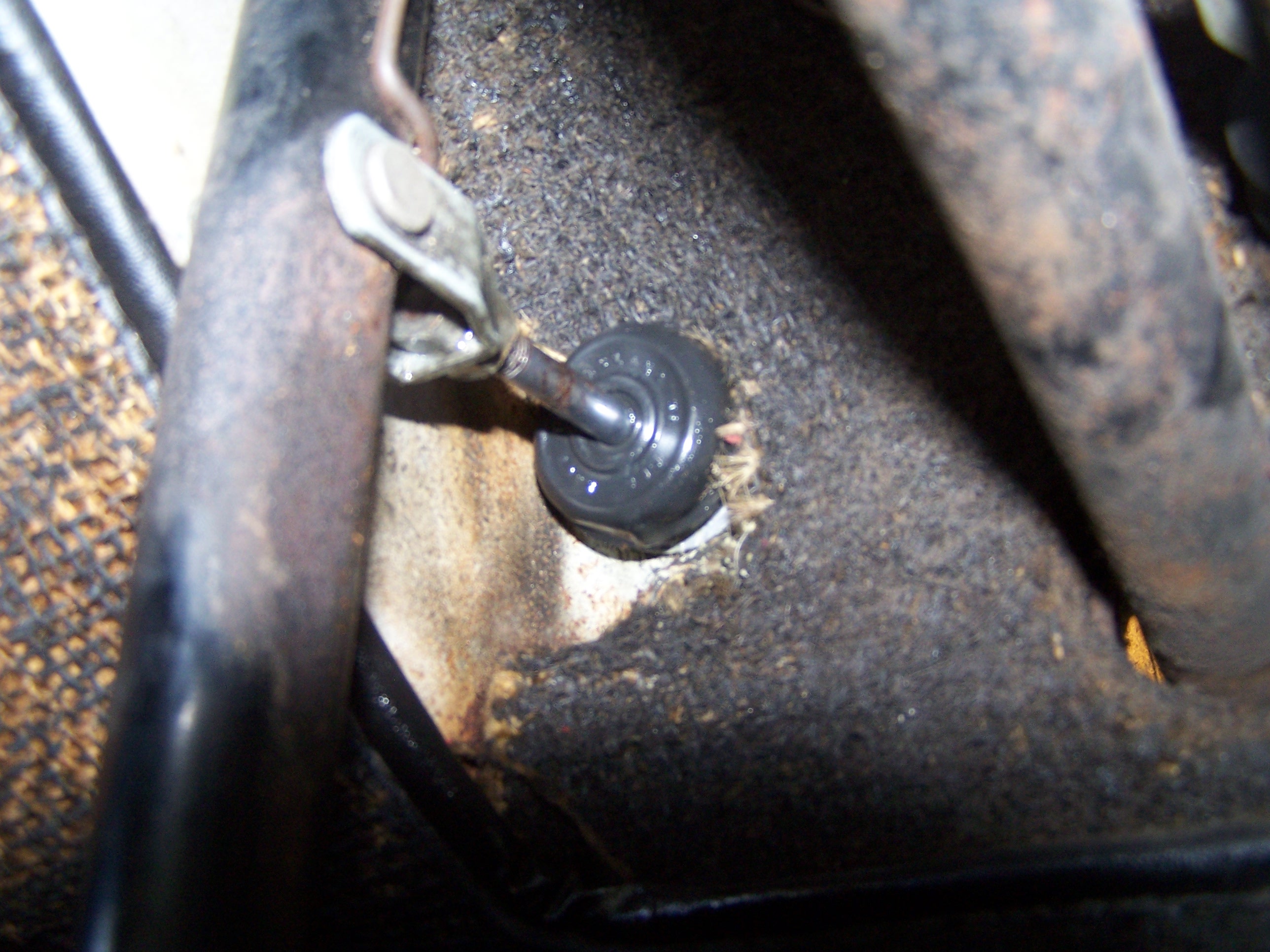

Okay, I had a chance to install the new clutch slave cylinder (see pic above (thanks Matt!))..... it seemed to work perfectly. I had to adjust the nut on the push rod because the new slave was slightly different, very easy to do. After bleeding the line, the clutch seemed to be working perfectly. I didn't touch the clutch master cylinder because it seemed to be functioning properly. It was pushing fluid when I pushed the clutch pedal so I left it alone.

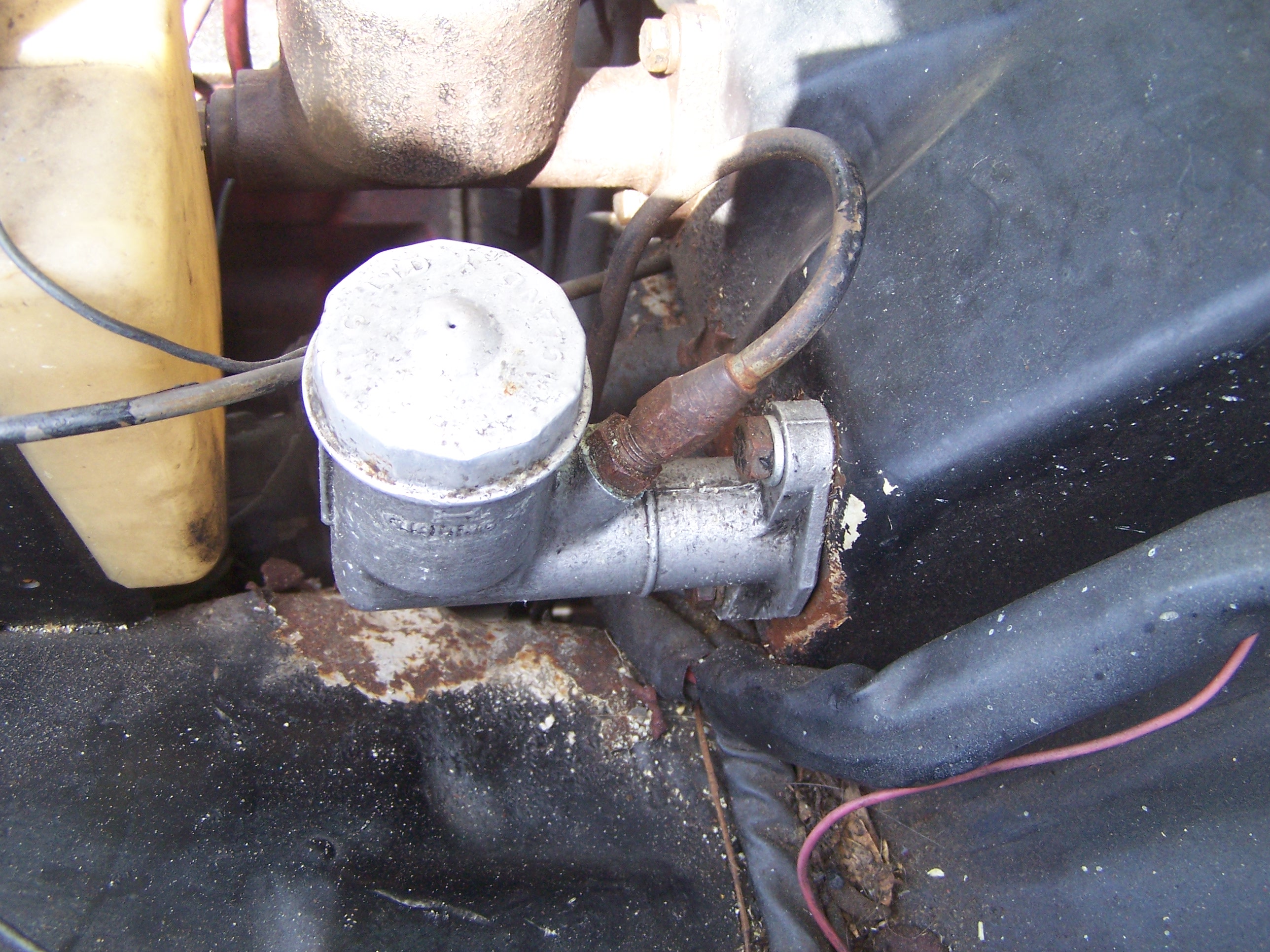

I also reinstalled the brake master cylinder after taking it apart and cleaning it thoroughly (see pic above). I used the vacuum bleeder kit I got from Harbor Freight Tools to bleed the lines. It was cheap ($24) and cheesy but did the job. I bled both rear brakes by pulling the fluid through the lines with the bleeder tool. The new brake fluid was clear (not cloudy like the old fluid) so I basically sucked out all the old fluid until I saw the new fluid come through. With the old fluid came some debris. I felt good about the bleeding.
After we finished we hopped in the car for a short spin around the block. Keep in mind, I disconnected the fuel line to the tank because I didn't want to run the 10 year old fuel through the system. I have a small one gallon tank "MacGyvered" into the engine compartment (does anyone remember the show MacGyver?). I have a 1-1/2" socket jammed into the mouth of the fuel tank with the fuel hose shoved into the 3/8 in square hole....... not OSHA approved to say the least.
Anyway........ it's about 8pm now (dark outside) and we take off down the block. The clutch works great and we are in first gear driving along. I push the clutch in to shift into second gear and the clutch now won't disengage...... damn! The master clutch cylinder seal burst. Looking back, I probably should have spent the $20 and bought the rebuild kit. This car is totally foreign to me and I am stuck in first gear, in the dark, (I forgot to mention that I live in a hilly neighborhood). So I'm trying to find a good place to flip a u-turn so I don't have to stop the car (thus pushing it home...... in my hilly neighborhood). The whole time I'm thinking about my non-OSHA approves MacGyvered gas tank sloshing around under the hood. So I see a break in traffic and flip a u-turn. We made it back to the house- barely.

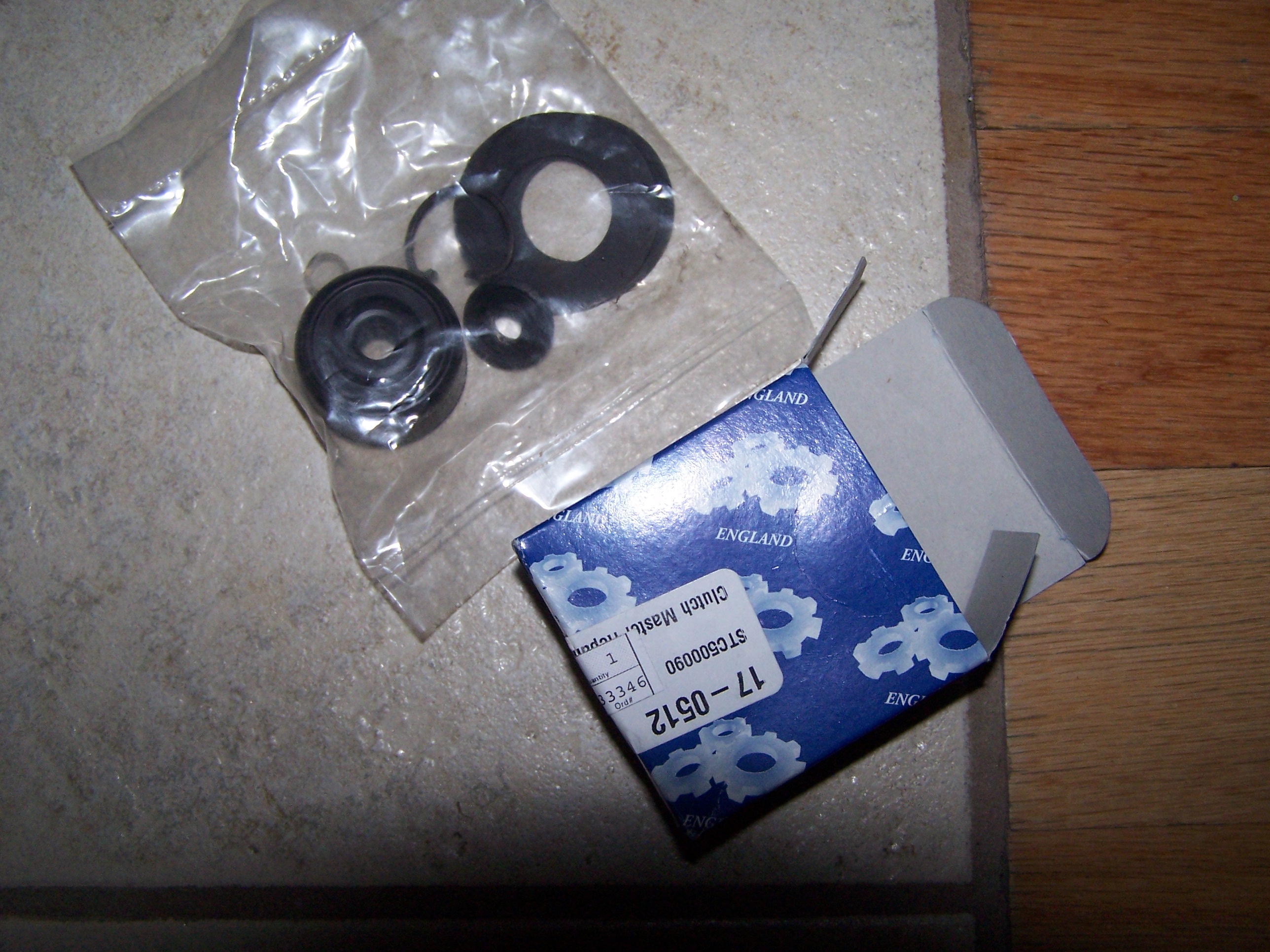

I didn't want to wait for snail mail so I went down to my local independent Volvo shop and bought the rebuild kit (see pic below). It was stocked and cost me $45! I plan to rebuild the cylinder and reinstall it tomorrow. After the test drive incident, I also plan to rebuild the brake master cylinder too. I will order that one online and install it next week.

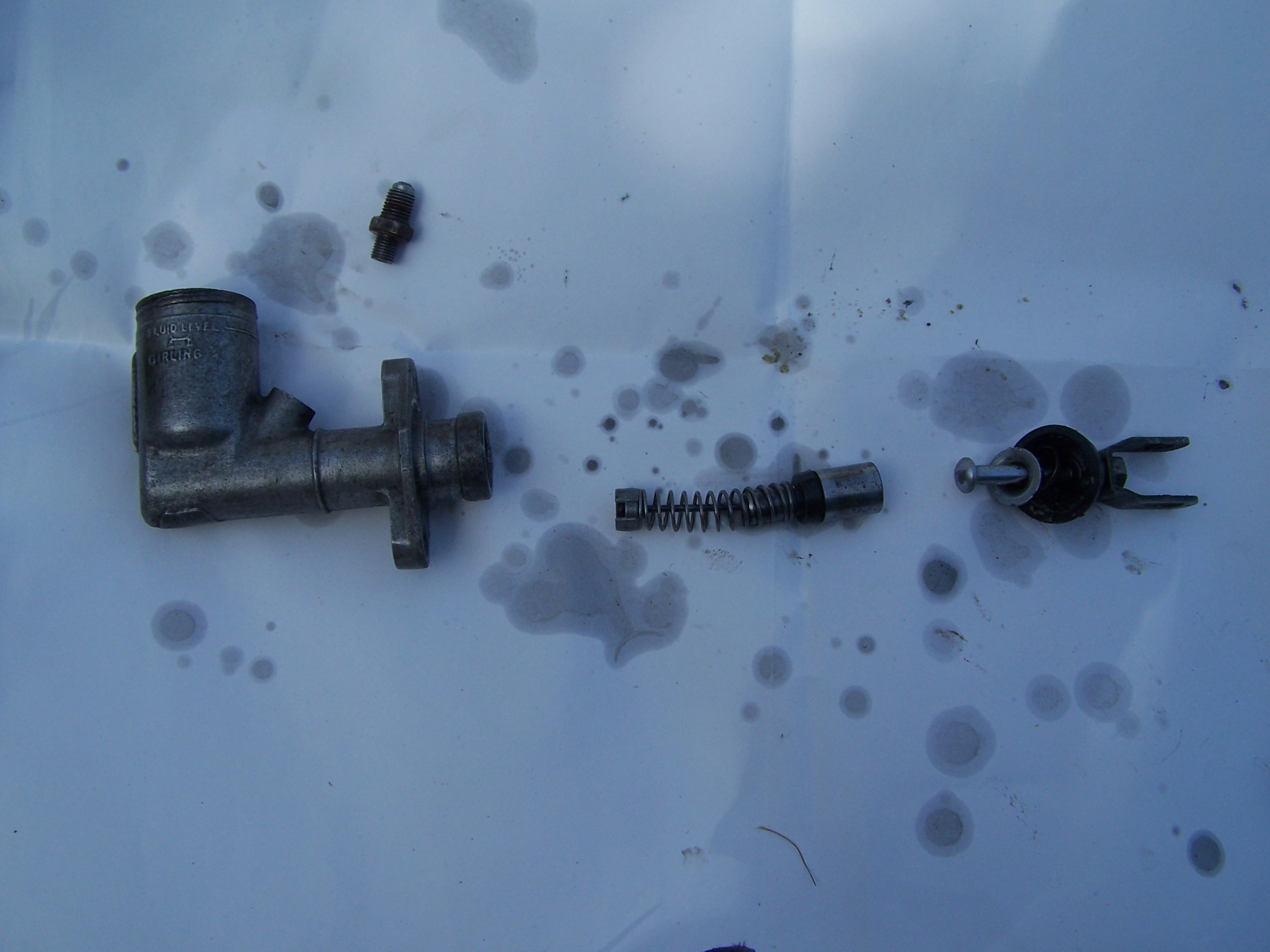

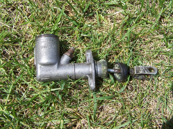

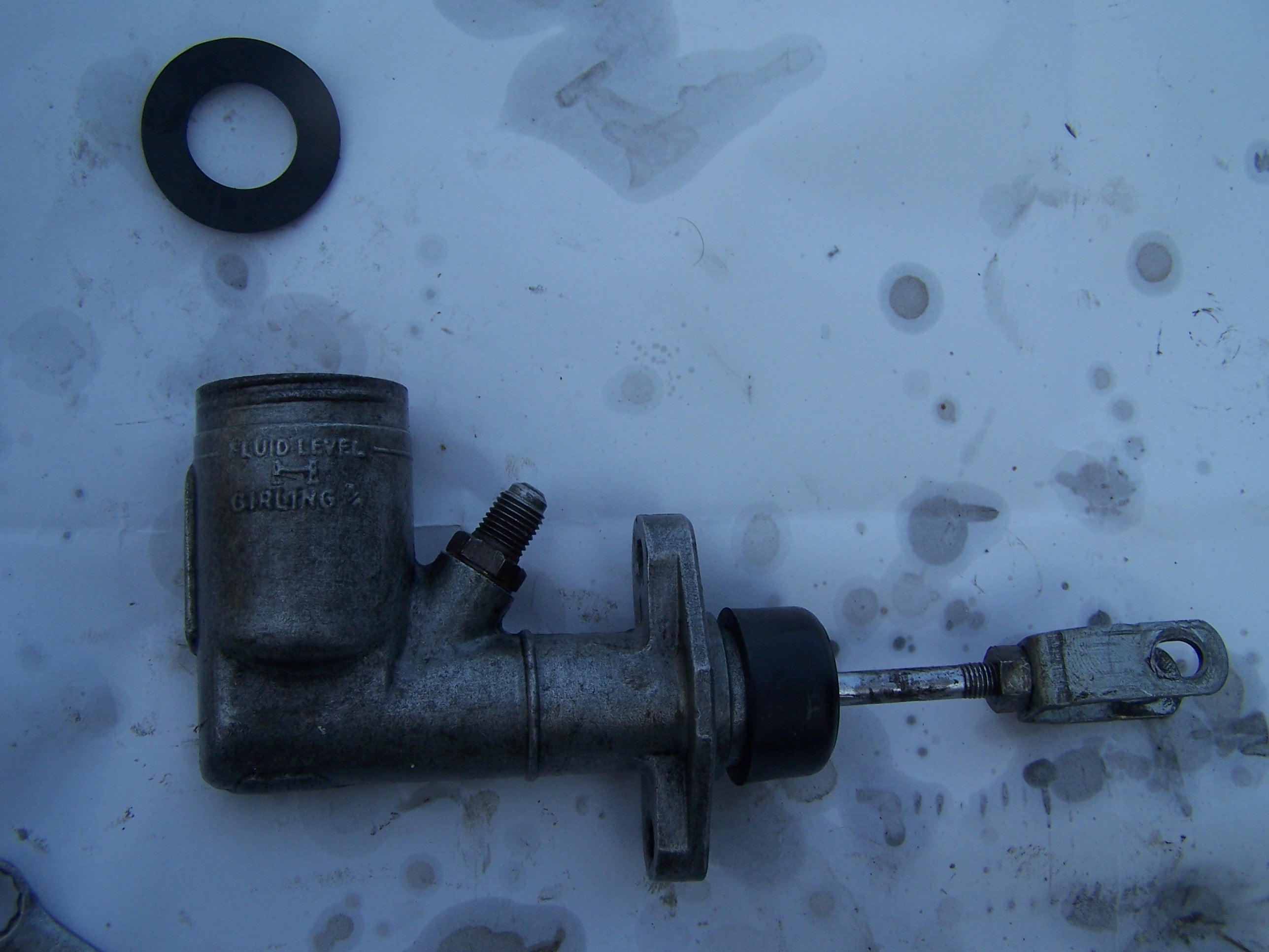

Today I rebuilt the clutch master cylinder. The pics are out of order as they upload backwards.
The first picture is of the rebuilt cylinder. I labeled additional each photo....
Read this section last...... After finishing the job, I drove the car around the block and the clutch worked perfectly, but I found the brakes were soft. I still think the brake master cyl is good because there is no leaking from the dust cover attached to the brake pedal, but will buy the rebuild kit just in case. I assume the leaks are at the wheels. Wheel cylinders are only a few bucks so I plan to place an order this weekend. I'm tired of paying $45 for parts I can buy online for $15 (sorry independent volvo mechanic, you need to find another sucker to pay for your kid's college tuition).
- Here is what the guts of the cylinder looked like. It was a pain in the &$$ getting it apart. The biggest problem seems to be lack of knowledge on my part...... I did admit in an earlier post that I'm not a car guy. Just imagine a confused ape holding the cylinder in hand and scratching his head with the other. Okay, back to the car.... There is a spring keeper ring under the dust cover thingy that removes easily. When you pull the pin, everything on the right side of the pic pops out (piece of cake!). It allows you access to the little piston inside. This is the confusing part..... you can press on the piston and it springs back and forth, but doesn't come out. I go inside and grab my $45 rebuild kit (the little plastic bag that feels just like a free toy in a Happy Meal.... I got screwed on that one). And the $45 kit didn't even have any instructions. Google was my next option...... no help there. I'm on my own here. I lube everything up, and even remove the little fitting on top thinking that it would help, it didn't. That damn little piston is pissing me off now! So with some cussing (and I'm ashamed to say, a few tears) I start working the piston like crazy. After 5 minutes, I noticed the piston is now traveling to the edge of the cylinder housing! Another minute and she's out! The center portion in the photo is out and ready to rebuild. I used some wd40 and thoroughly cleaned all the parts. I rebuilt the cylinder and threw it back on the car.
Bleeding the cylinder required opening the fitting on the top of the master. I am sharing this valuable information with you free of charge. Trust me..... after 20 minutes of pumping the clutch (thanks to my impatient 11 year old son), and opening and closing the bleeder valve on the slave (under the car), we realized that the air trapped in the top bend of the tubing would only come out after you crack the top fitting......
