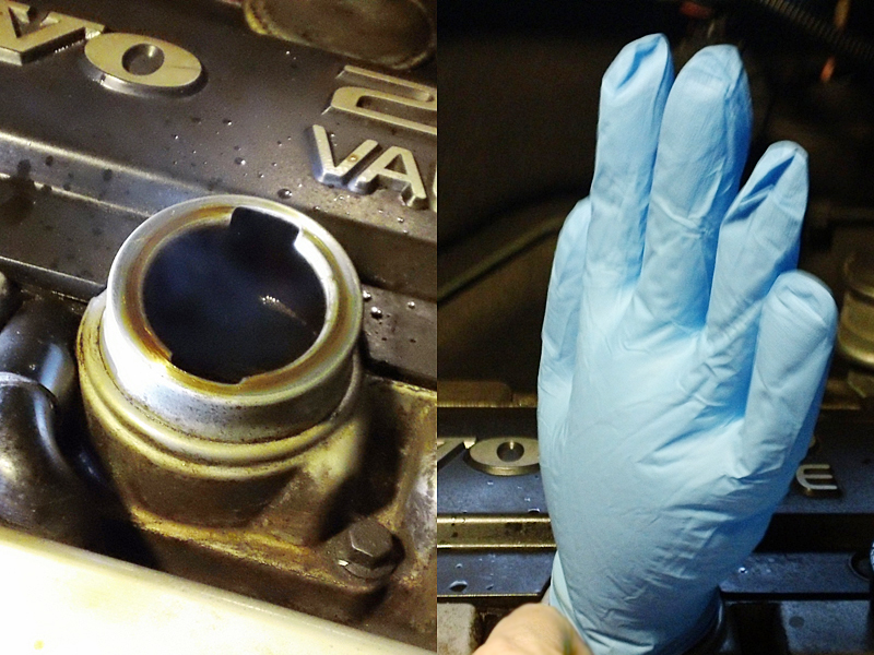

jblackburn wrote:Same basic test. Pull out the oil stick, look for smoke, or put a balloon over the opening. If you see smoke, or the balloon inflates, the system needs to be cleaned. Let us know the results, and I'll dig up the non-turbo write-up, I think it's on my work computer or hidden in my bookmarks somewhere :)
OK. This test may not be good enough to keep a balloon up in SantaFe this Fall. But it certainly raises hand to make my to-dos in 30 days. Or should it be earlier, immediate?
'97 850 NA - a negative PCV
Will there be Gremlins in waiting as I take on the PCV job?
