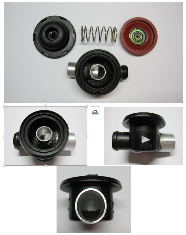

Excellent tutorial which helped me rebuild the air pump in my 1997 V40.
I preferred to replace both bearings and all went well.
However, when you mentioned the air valve could not be repaired, I read that as a challenge. I repaired my valve using an aluminium tube from an old bicycle pump and used a 2 part epoxy metal glue to hold and seal it in place. The inside had "rotted" out and the tube was a tiny bit larger than the original which meant the valve base had to have a channel cut into it. But as the center of the base part was also friable, I had no problem with cutting the channel.
After reassembly I tested it using a syringe to pull a vacuum that opened the valve nicely.
Tricky to get the valve seat square and to the correct height for the diaphragm to seal against.
Having said that, I have no idea how badly your valve was damaged. If there is an interest, I could post more detailed instructions.
