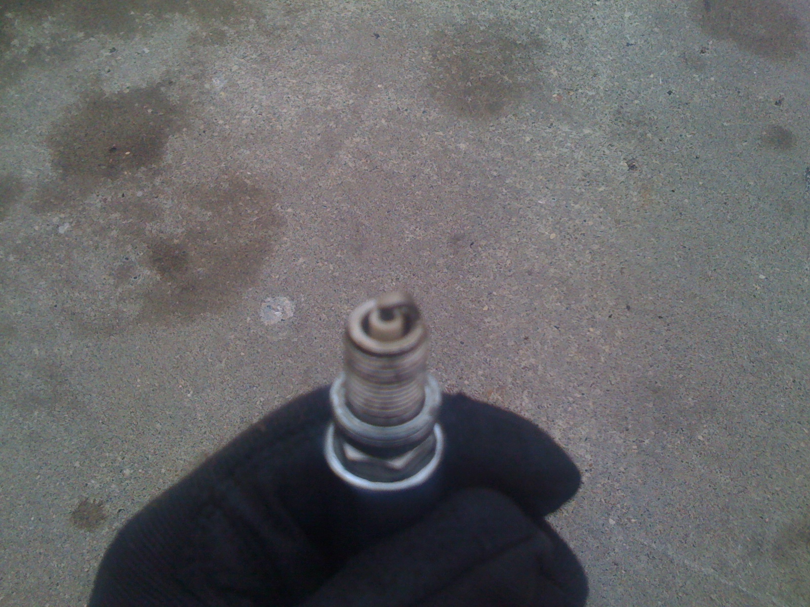

Some interesting developments today.......
* My compression gauge took a dump, it no longer sticks at the highest reading.
* Spark plug on cylinder #5 was completely clean, i.e. no combustion happening in that cylinder. It wasn't flooded with fuel either.
* I dropped some Seafoam into the cylinders, turned it over a couple of times, dropped in some some and let it sit for about 20mins.
* After clearing the seafoam out, looking with (now dud) compression gauge all 6 cylinders seem to build and drop pressure in a similar pattern. For sure I could hear the starter motor loading up a little on the compression stroke on #4 which wasnt happening two weeks ago.
* I through impatience I mixed up the coils, so I'm not 100% sure what coil was on cylinder #5....however...
* I started up the motor and removed and replaced the injector cables in sequence, the motor note changed on on every cylinder EXCEPT #1
* After going through the injector connectors, I cleared the OBD codes and after a while a Cyl #1 misfire code was pending.
Its hard to say, but I have a gut feeling that the compression has improved. The idle seems to be a little smoother, like it was a couple of weeks ago and the car doesnt judder as much when I put it into drive.
I "think" I might have had a combo of bad compression AND a dud coil which appears to be in cyl #1 right now.
Next step is to take all that damn turbo piping off again and swap coil #1 with another and see if the misfire moves with it. At a later stage I hope to get a compression gauge that works.

Thanks. I should know more when I swap the coil and\or get a compression gauge. Heres a pic of the plug that came from cyl#5. It has about 400 miles on it. What interesting is that the low compression reading was on #4 so frankly im confused.

Perhaps the low compression readings were due to your malfunctioning gauge all along?

vegasjetskier wrote:Perhaps the low compression readings were due to your malfunctioning gauge all along?
That would be nice, but I dont think thats the case. The gauge still measures pressure, it just doesnt telltale the highest reading. In the original tests, I went back and forth between the good and bad cylinders and got consistant results.
Time will tell, I hope to have time to swap the coil on Cyl#1 tonight. Ive pulled the injector cable off in the meantime, I dont need that fuel eating up my cats!
