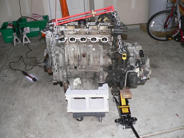

wheelsup
- Posts: 1296
- Joined: 28 June 2005
- Year and Model:
- Location: Raleigh, NC
- Has thanked: 15 times
- Been thanked: 20 times
I looked at that and wasn't impressed. I felt it wouldn't have the necessary coverage on the bottom due to the design of the transmission. I ended up doing this:whoa wrote:Can you use a transmission adapter for your floor jack?
http://images.harborfreight.com/cpi/pho ... /95640.gif
Worked well once I figured out the procedure. When I initially took the tranny off I used a small floor jack with wood below it to hold it up and it got off balance quickly. They are heavier than you can imagine. To do it without killing yourself you really need some way of lifting it up and into place, rope around the transmission sounds pretty wobbly. It's a BITCH to get it lined up correctly.
