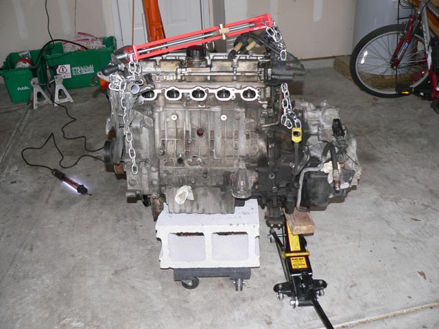

I decided to remove the entire drivetrain, swap the transmission and reinstall the engine/manual tranny as one piece. I don’t have air tools but I did have a friend help me for at least half of the job. I did it over a period of three days and probably a total of 12 hours. Interestingly enough I spent at least 5 hours of that time installing the clutch pedal, master cylinder and bleeding the clutch.
I have at this point pulled 3 850 engines.
“all due to transmission’s” and two of these instances were in 2010! Hence I bite the bullet and got the manual gear, as I seem to be to attached to the car to let it go.
But I am not a mechanic, just an average guy who tries to do his own stuff. “tries”.
I understand that volvo charges 8 to 9 hours to change the clutch in a manual 850. But there is alot more to it when you have to change everything inside the car too. pedals, shifter,cables, etc……

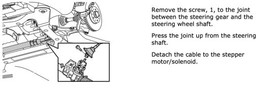

I actually found it to be an easy swap, short of the clutch pedal assembly. Had to dissconect steering column for this and very awkward position to work in.
I did have one huge issue, car won’t run.
But it is a damaged crank sensor not allowing spark/fuel. This is most likely my fault, or coincidence that the sensor finally died at this time. I have read many swaps and the guys didn’t have the no start issue, so don’t let that scare you. I’m just special..
