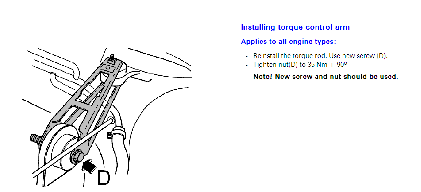

Upper Torque Arm bolt/nut - see attached pic. I can't figure out a part number. Really you could probably re-use it, but it's a angle torqued bolt so it stretches.
Upper Torque Arm replacement
1995 850 GLT Wagon w/ 200,000 miles
