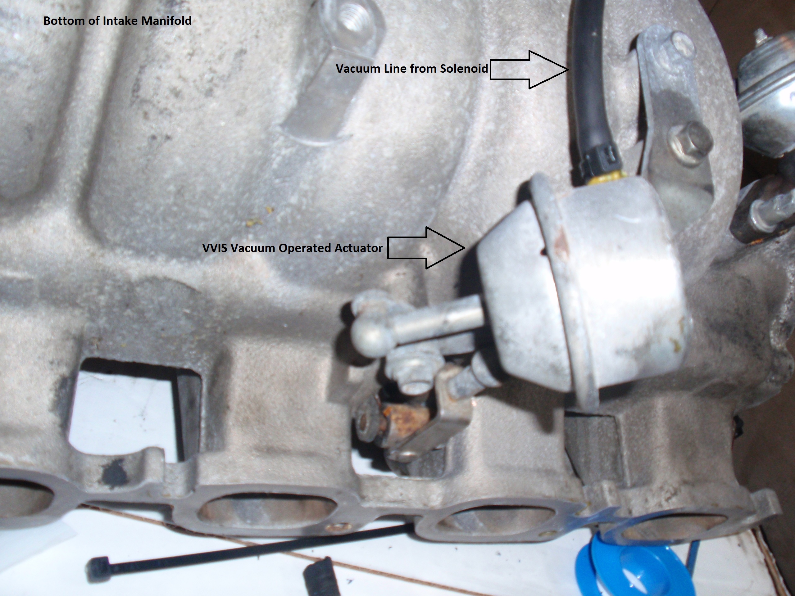

This is the vacuum actuator for the VVIS that I needed to control, that's 1/8" ID hose.

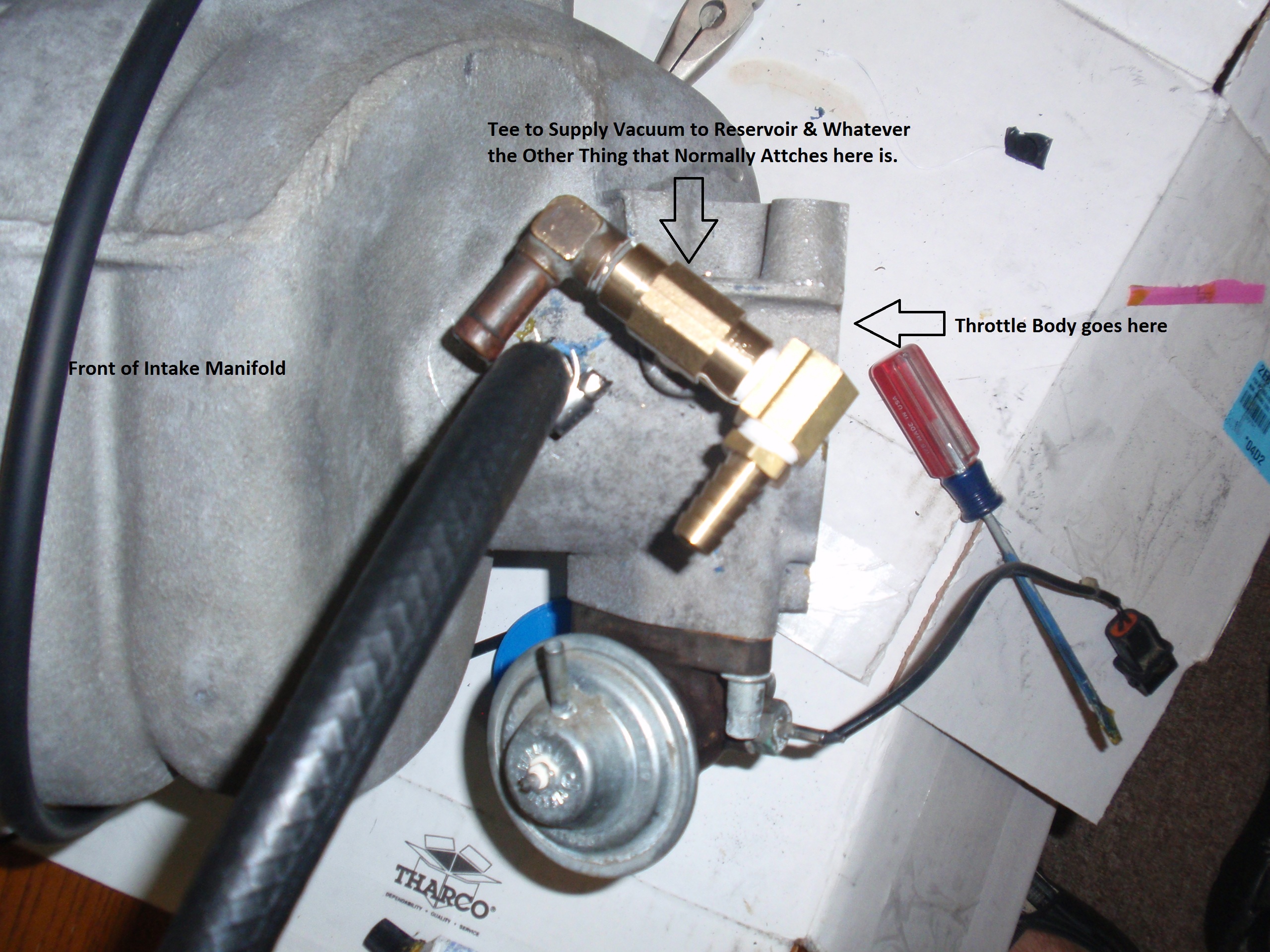

I had to have a vacuum source, so I T'd the 1/4" factory vacuum port.
Here's a good look of the Tee with the manifold back on the engine, that's 3/8" ID hose.
With everything back where it's supposed to be, the vacuum T is hidden behind the Idle Air Control.
