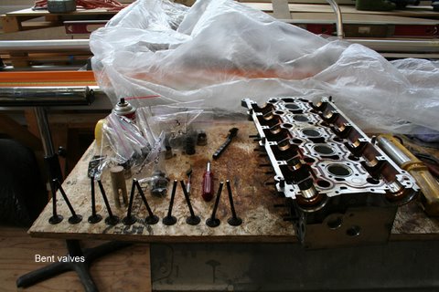

If the starter is used on a whiteblock with the valves out of time it usually bends all of the valves on one side -they look like this.
But right now we wait for the OP to give us info on
1. Are the timing marks right?
- Volvo whiteblock bent valves.jpg (42.21 KiB) Viewed 3693 times
