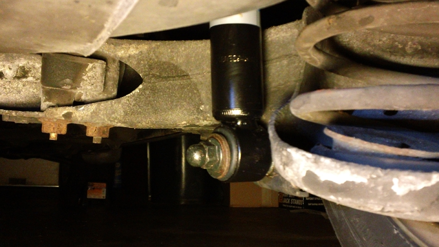

Ben850 wrote:I did mine this morning. the right side came out easy, so I figured the other side would be as well.
The attachment IMG_2031.JPG is no longer available
Ben850,
Your cap nut looks nicely centered in the photo above. Any suggestion for mine, here is the photo.
cap nut could go up a little and centered

I don't know if you noticed, but the sleeve is flared from the middle to the outsides. the bolt actually pivots within the sleeve. I think I may have taken that photo after cranking the nut on. I probably still had the jack under the delta link from when I slid the bottom mount over the bolt, so it was still centered
I wouldn't worry if yours doesn't look centered at the moment. It moves.
