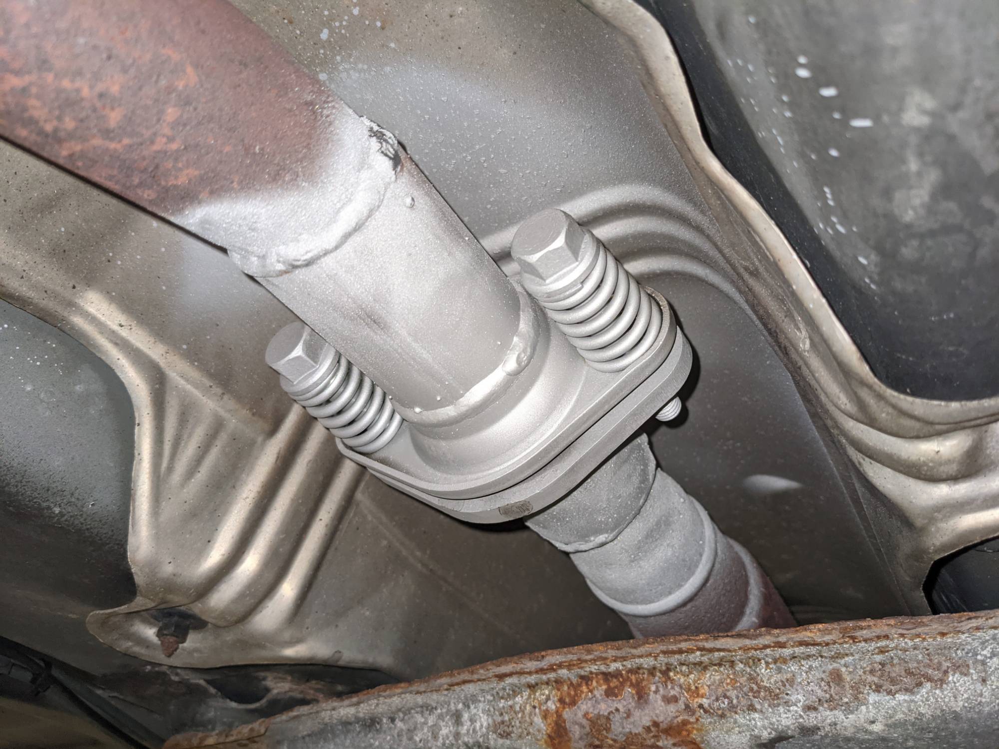

The connection between the catalytic converter pipe and center muffler is a terrible design. The Volvo clamps are hard to align and tighten so they make a perfect seal. One solution, especially if part of that connection rusts out, is to have a muffler shop weld the cat and muffler pipes together. But then you can't remove the muffler if, for example, you need to repair/replace the heat shield when it rusts or its clips fail. Every time you need to remove the muffler, you'll have to cut and weld the joint, making it harder to work with.
The best solution is to replace this connection with the Bear River Converters BRC8175SS flange kit. It's got new flange ends for both the cat and muffler pipes, a metal gasket between them, and spring loaded bolts to hold them together. It's T409 stainless steel and warrantied for life. It's for 1 3/4" pipe which is exactly what my 2000 V70 used.
My muffler pipe rusted right at the joint. I really wanted to preserve the cat ball flange so any new muffler could easily mount to it. My local muffler shop could have welded a 2" pipe to the muffler and flared it, but it surely would have fit even worse than the original.
Instead, I had my local muffler shop weld in the BRC flange kit. $32 for the kit, $70 for the weld, 15 minutes at the shop. My car sounds perfect and I can easily remove the muffler to finish fixing my heat shield. When my muffler fails, I'll carefully cut off the flange and see if the muffler shop can weld it to the new muffler. If not, I buy another $32 kit and use one of its two flanges.
As an alternative to welding, a reviewer on the BRC site used band clamps. See the picture posted to the review. I've had band clamps rust out, if even because their screws failed, so went with welding to reduce the chance of future problems.
Thanks to giovannibianco for leading me to replacement flange kits and as400jockey for referring Bear River Converters.
Before trying this kit, I tried the split flange clamps which as400jockey recommended; the Bear River Converters FX35. Unfortunately, the company which makes those clamps, FX Exhaust, went out of business in December 2021. I tried to buy similar clamps from eBay from a Canadian seller (I believe FX Exhaust was Canadian and other exhaust flanges I've bought were made in Canada). Though they said they were for 1 3/4" pipe, they were too large to grab the original Volvo flared pipe ends. They're a good solution for keeping your original flange if you can find ones that fit.
