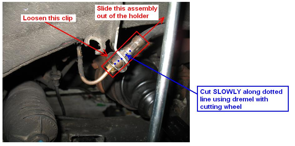

I am just wondering (yes, just wondering) if anyone has done this technique for seized connection.
Assuming heat from a propane torch fails to undo the seized connections...
1. Loosen the C-clip to allow the whole assembly to go upward.
2. Slide the whole assembly upward.
3. Use a dremel with cutting wheel (wear goggles!) and SLOWLY cut through the hose's metal end.
Go SLOW and constantly check to be sure one does not damage the nut threads.
Once you get down to about 1mm to go, use a chisel or screwdriver and split the connection.
In other words, think like a surgeon operating and cut slowly.
Does this idea sound good? This idea (if it works), would prevent you from flaring the line etc.

You probably could, but even if you did manage to not touch the threads, the prying action would probably damage them
If you know ahead of time that you need to loosen, PBlaster it to death the day before and again before loosening

That would take a really good touch to Dremel without damaging the thread. The Dremel bit is circular so you have to control the depth of a few mm at the deepest circumference of the cut.
You might be able to measure the depth and mark the Dremel bit with a sharpie, but those bits usually wear as you cut and change the radius .....sounds tough.
Maybe practice on an old one from a junkyard?

You can't loosen that c-clip, it's held in place by the pressure of the nut bolted into the hose, so you'd have to break it & replace it. Another challenge would be your idea of sliding the connection up (indicated by the red box & arrow in your pic). The hard line may not bend enough with the proper alignment, and (2) the nut may not lineup with the hole in the mounting bracket so it wouldn't slide very much. Another thought would be that whatever caused the two parts to become seized will probably not 'let go' easily, and with all the dremmeling you'd have to do, odds are pretty good you'd chew-up the threads of the nut, which you're trying to save.
