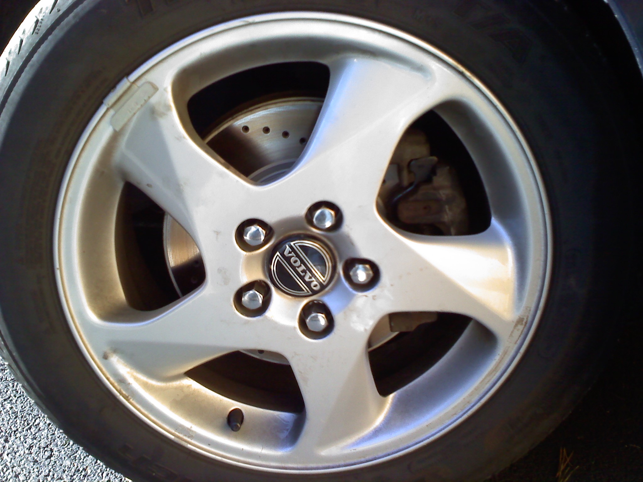

Got her back together! As always, some minor complications.
I went with Akenbono ceramics and the Zimmerman cross-drilled rotors. Thanks to everyone for the advice.
Thanks especially to fellow Blacksburg member t5ftw for coming out to help me & having all kinds of awesome tools. We had a good day of changing brakes, trying to find missing parts, and changing the coolant on his car. :mrgreen:
Also changed out the brake fluid, bled the brakes, and changed PS fluid. A side note for anyone trying to compress the caliper piston...put the caliper against the frame of the car and pump the jack up into it. Voila! Compressed piston in about 10 seconds...much better than sitting there prying at it like I did on the back ones. :mrgreen:

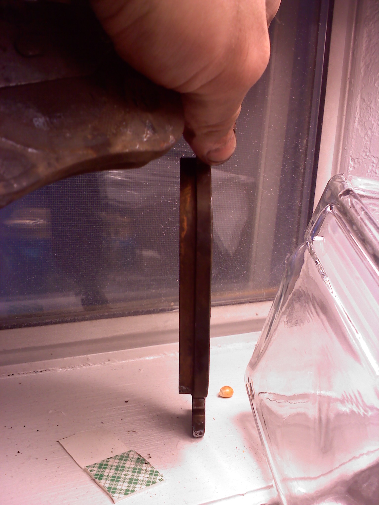

Whatever moron installed brakes last time left off one of the caliper bolts on the left side :!: , and there's no SPRING on the right side (probably why that one was squealing to begin with!) :evil: The old pads still had probably 10,000 miles or more in them - I was just tired of them shrieking every time I came to a stop. The rotor on the left was nearly impossible to get off from all the rust - right one came off in 3 whacks with a hammer.
I'm extremely pleased with the smoothness - and stopping power is very good so far once the pads wore in. I'll have to see how they do on a cold morning.
End result =)
End result =)
Old brake pads
Old brake pads
