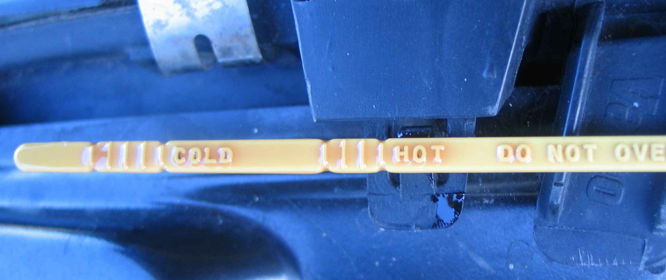

This morning I decided to check the ATF level with the car running after a 20 min drive just to see how the level was. When I checked it cold the other day it was up onto the writing above the level mark so a bit over filled. The result when hot is shown on attached photo and again looks to be over filled and up to the "do" on the stick. I did run through the D to P a couple of times first before checking. Would this be enough to cause the flaring in the lower range, which it decided to do briefly on my drive today. Obviously when I change to the 3309 fluid at the weekend, I will make sure it is at the correct level, just curious to know if this might be affecting it?

Overfill, underfill... both cause bad behavior. And damage, depending on how long the over-/underfill persists.
As Matt said, yeah, it could cause that.
