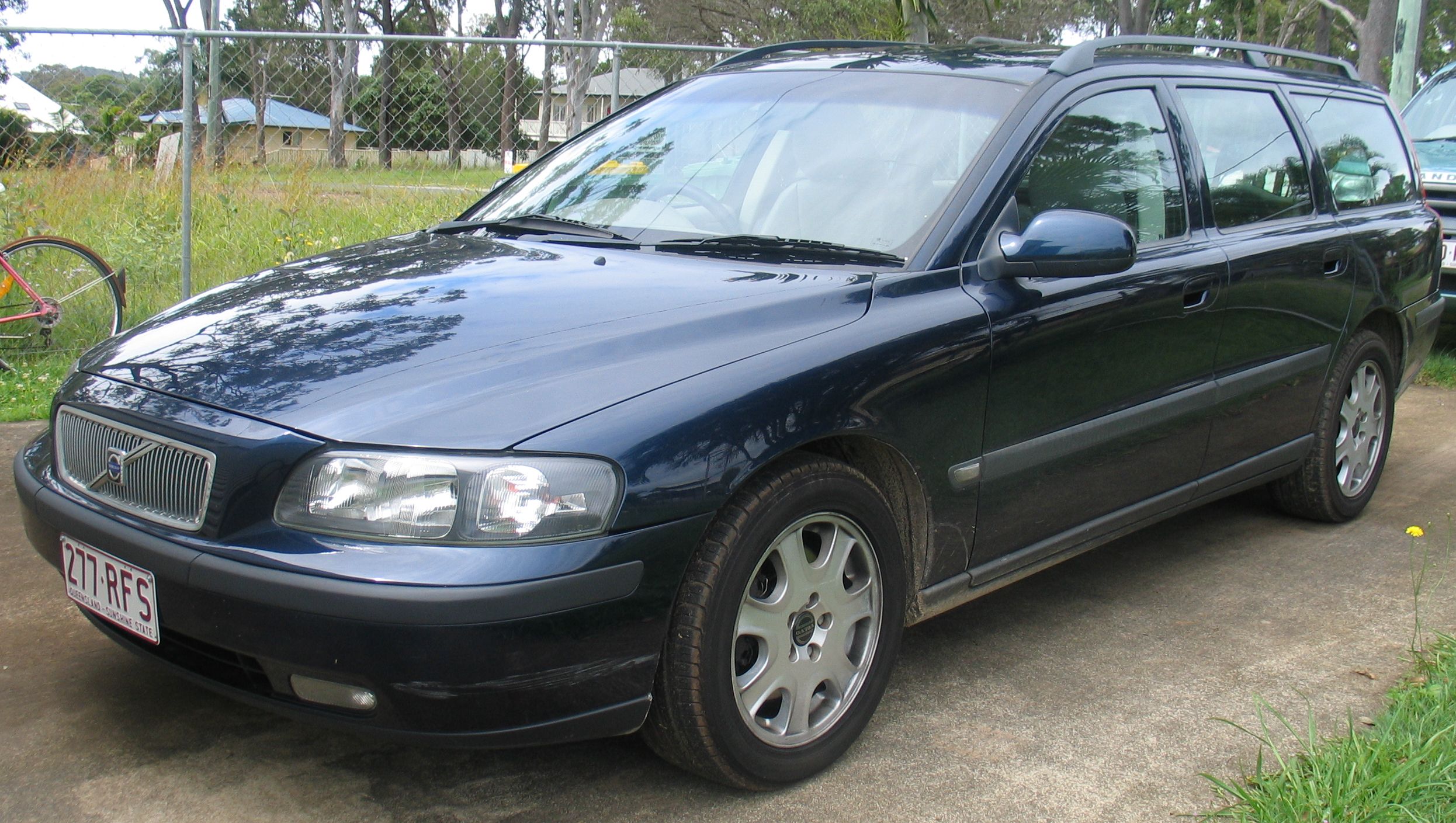

My latest edition, which I found last week, is a 2000 V70 T5 with 140 tho K's on it (about 86k miles) which I brought at auction from a deceased estate. It had been sitting in a garage for the past two years so was a little dusty and faded but in excellent condition. Because it was unregistered I was unable to test drive it and so brought it having only heard the engine run, which sounded good. I was able to drive it a few feet within the confines of the yard but that was it, so a bit of a gamble re the trans . I trailered it over to my local European car specialist garage for a full service which they did in a couple of days. every thing was fine apart from the electric window drivers side which needed a new part. He mentioned that when they drained the trany oil it was very black and so they flushed it a couple of times before adding new. When I finally phoned him up to arrange a time to collect it he told me that everything was fine apart from the gear box having some issues, but it could improve as the new fluid starts to lubricate a gearbox that had been static for so long. I Arranged to go and collect the next morning and had a very sleepless night. We took it out for a test run and sure enough it was slipping and reving out of gear but it was apparently better than it was the day before. I gingerly drove it the ten miles home with it still playing up, mainly in the lower range. Since then I have taken it out a on a couple more days and surprisingly it has improved and yesterday I decided to really give it a blast and did a few fast take offs just to see if it had cleared and sure enough, she ran up through the gear changes very fast and smoothly and is sooooo much better. It just does a little slip now and then in the very low range so not perfect but looking promising, fingers crossed. I know that there have been a lot of issues with these boxes and a lot of debate about using the correct ATF so could I get an opinion here please...My mechanic used Penrite fully synthetic ATF but I have no idea if this is correct as I dont know if it is up to the 3309 spec. I have attached details of the Penrite from their website, what do you think? Thanks people (sorry for the ramble)

I take what I know from my knowledge of the S70 line - in those, only the base NA models had the 5 speed auto. The GLT, T5 (which the S70 DID have for the 2000 model year), and XC models used the 4-speed, while the R's and base/SE models got the 5.
You may have what we refer to as a "2001" model - some countries classify the years differently. Does it look like this one? Or more like my blue one over there >>>?
If that's the case, do you feel a "thunk" when you let off the brake and hit the gas? If you do, get that car to a dealer as soon as possible and have the transmission software updated.
