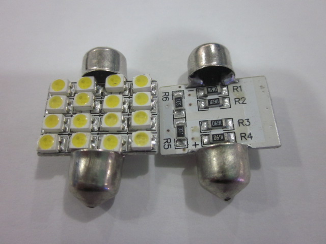

Its self explanatory really once you see the pictures below. The rear trunk SMD was a 16 unit festoon bulb that required no rewiring thankfully. 38mm in length.

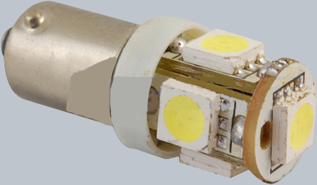

The standard filament bulbs for the holder are BA9S bayonet bulbs that consume around 5 watts each or 0.42amps per bulbs. consider we have four BA9S bulbs, this means 1.66 amps of power is consumed. The rear festoon bulb is a 5 to 8 watt bulb but its not activated by the front or rear doors, nor by the switches on the main panel.
The problem with SMD bulbs (Surface Mounted Diodes) is the same problem LED's have, if you reverse the positive and negative flow they will not power up and worst case can burn them out, fill your trash can basically. The holders for the BA9S bulbs in the Volvo have the polarity or +- in the wrong order for the SMD bulbs, the pin is negative and shell is positive. This is not a problem for filament bulbs are they work with any polarity direction. In most cases the pin at the bottom of the BA9s is almost always positive+ and the shell is almost always negative. In the Volvo this is flip or out of phase. This has been done to save on wiring which is fair enough but for us its a problem here.
So the reason I have soldered the wires on the pin and shell of the SMD bulb are so I can switch or cross the positive polarity or +- around.
The SMD bulbs require 0.3 watts each. four bulbs require 1.2 watts or 0.1 amps. 16 times less power than the standard BA9s tungsten bulbs. This means you can leave your courtesy lights on for days and not flatten your battery
It would takes 2 to 3 weeks to flatten a battery.
You can actually buy these SMD boards with leads coming out of them. This would be better for the Volvo's. The only reason I bought the BA9S SMD bulbs is I assumed the polarity on the Volvo's holders would be standard positive pin and negative shell.
If I had know it was flipped I would have bought an SMD board with leads or wires coming out of them and this job would have been much simpler. Half of my SMD are shining light in the wrong direction. A Board of SMD would shine light in one direction which is better here.
Below are some pictures of the different kinds of SMD available that can work well in our lighting systems.
Standard BA9S Bulb
SMD BA9S bulb, which I bought but you don't have to. Just buy the SMD boards with wires so you can install them with easy.
Festoon Bulb can be used in the trunk, 16SMD are very bright compared to a filament bulb.
I hope this helps.

- SMD board
- festoon SMD converter.jpg (23.01 KiB) Viewed 3448 times
- Festoon bulb with SMD
- Festoon-3016-SMD-Top-Room-Roof-Reading-Light-1206-SMD.jpg (80.62 KiB) Viewed 3448 times
- Standard BA9S SMD bulb
- SMD BA9S.jpg (83.83 KiB) Viewed 3448 times
- Filament BA9S bulb used in courtesy lighting.
- BA9S.jpg (10.58 KiB) Viewed 3448 times
