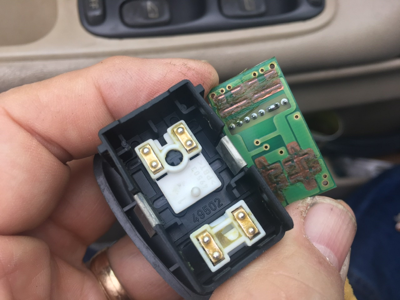

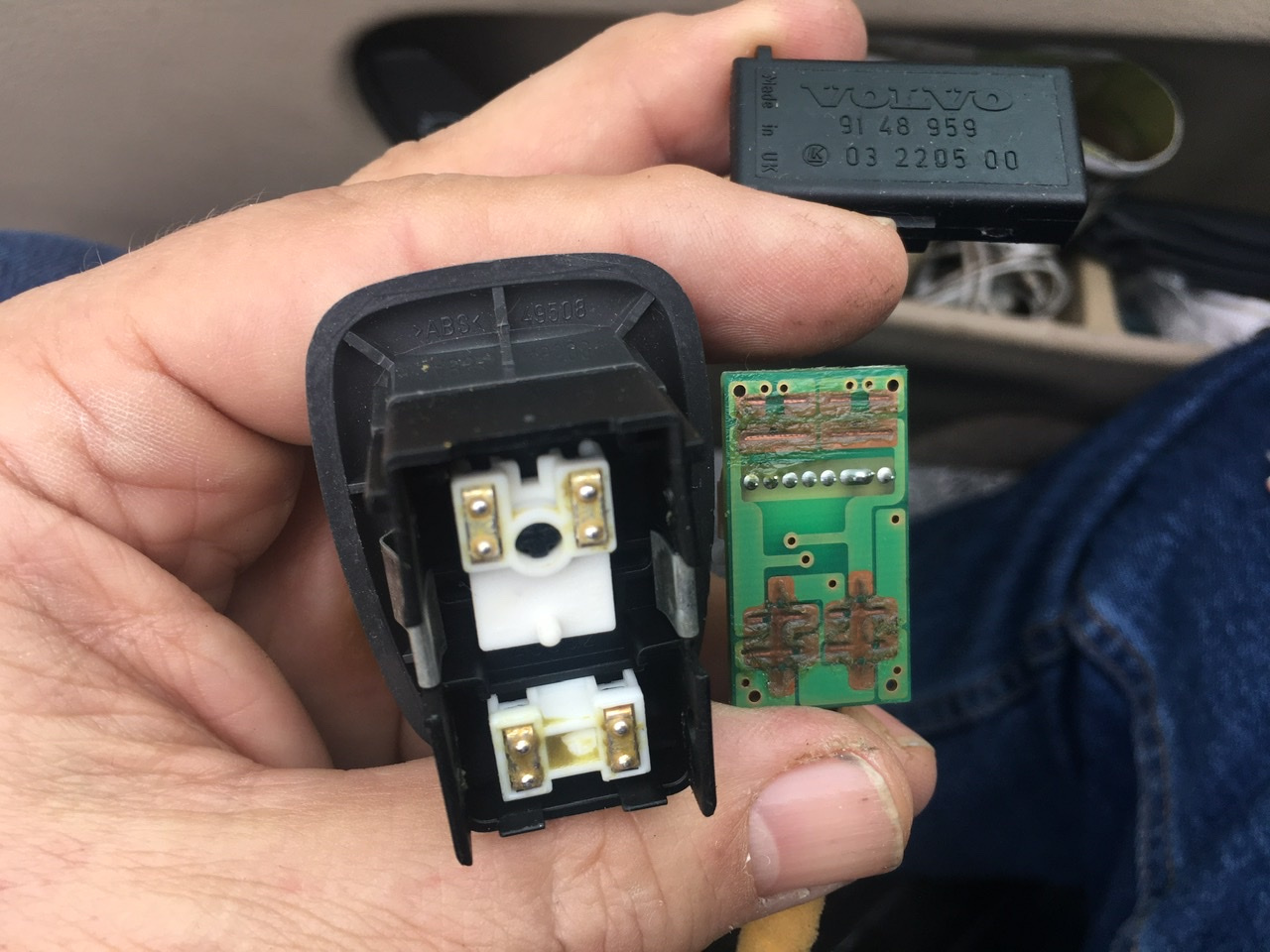

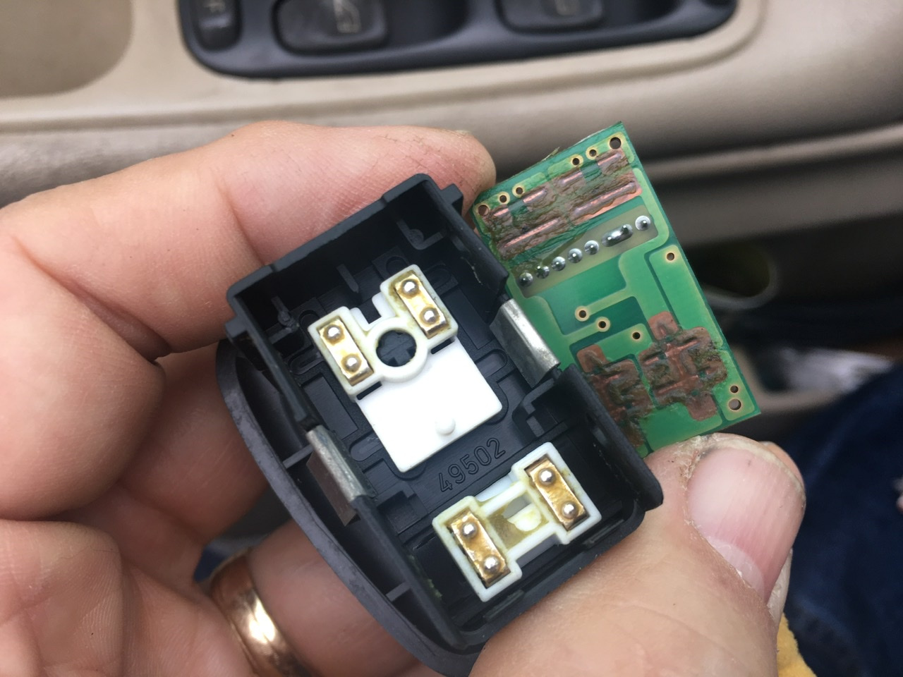

Much more than you ever wanted to know about your mirror switch.
If it’s yours clean it up with alcohol or get a used one $30 ebay, $5 junkyard
If it’s SWMBOS, thank the Creator for a partner who drives a 20 year old car and get a new one from FCP for $60

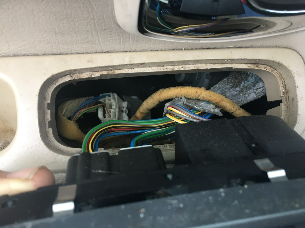

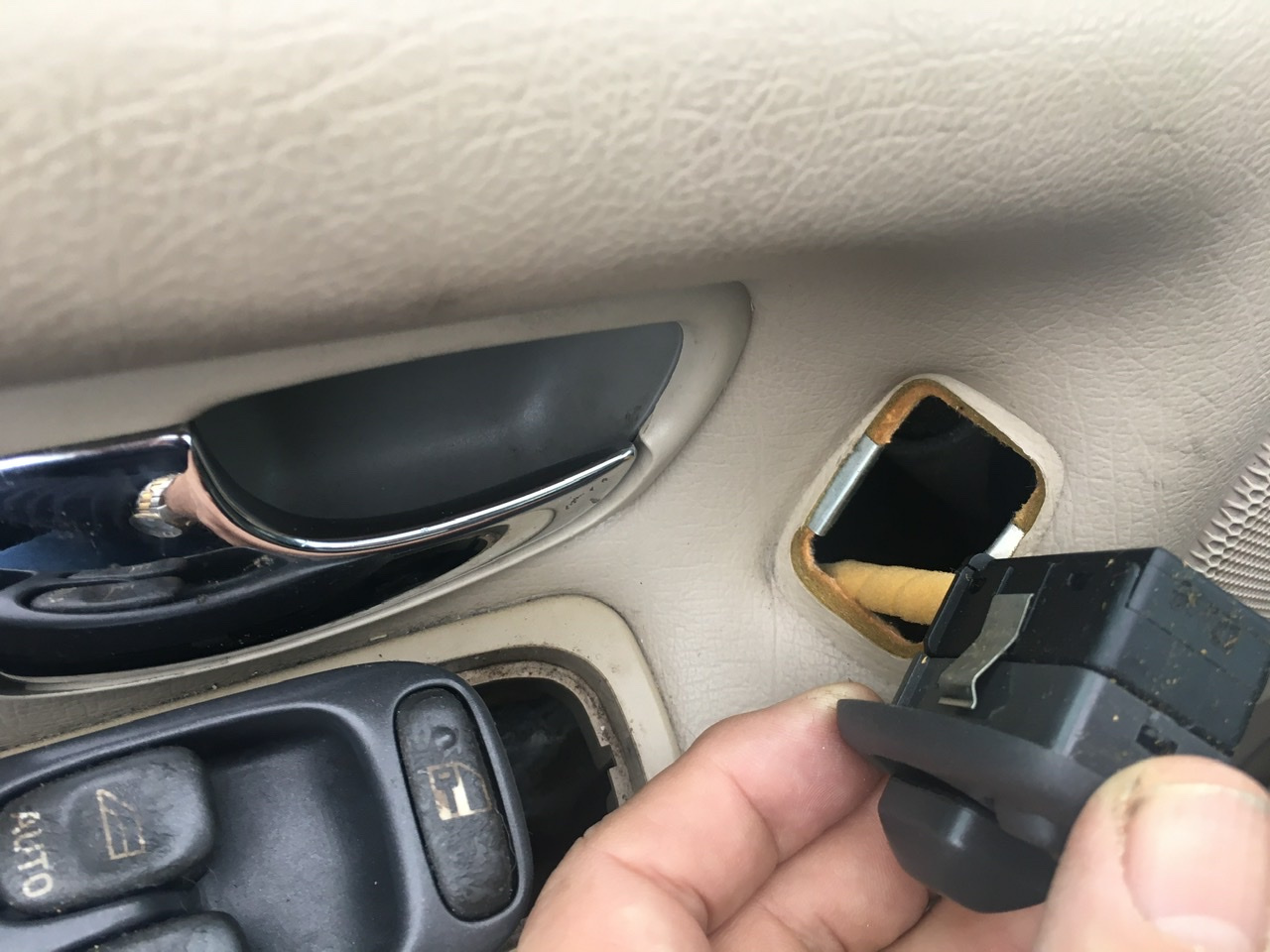

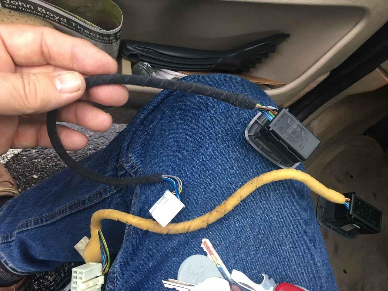

Pop out window switch
Pop out mirror switch
Route wire into connector
Click!!
Push them both back in
Blunt Swiss army knive works to pop the switches. Note location of metal spring catches
