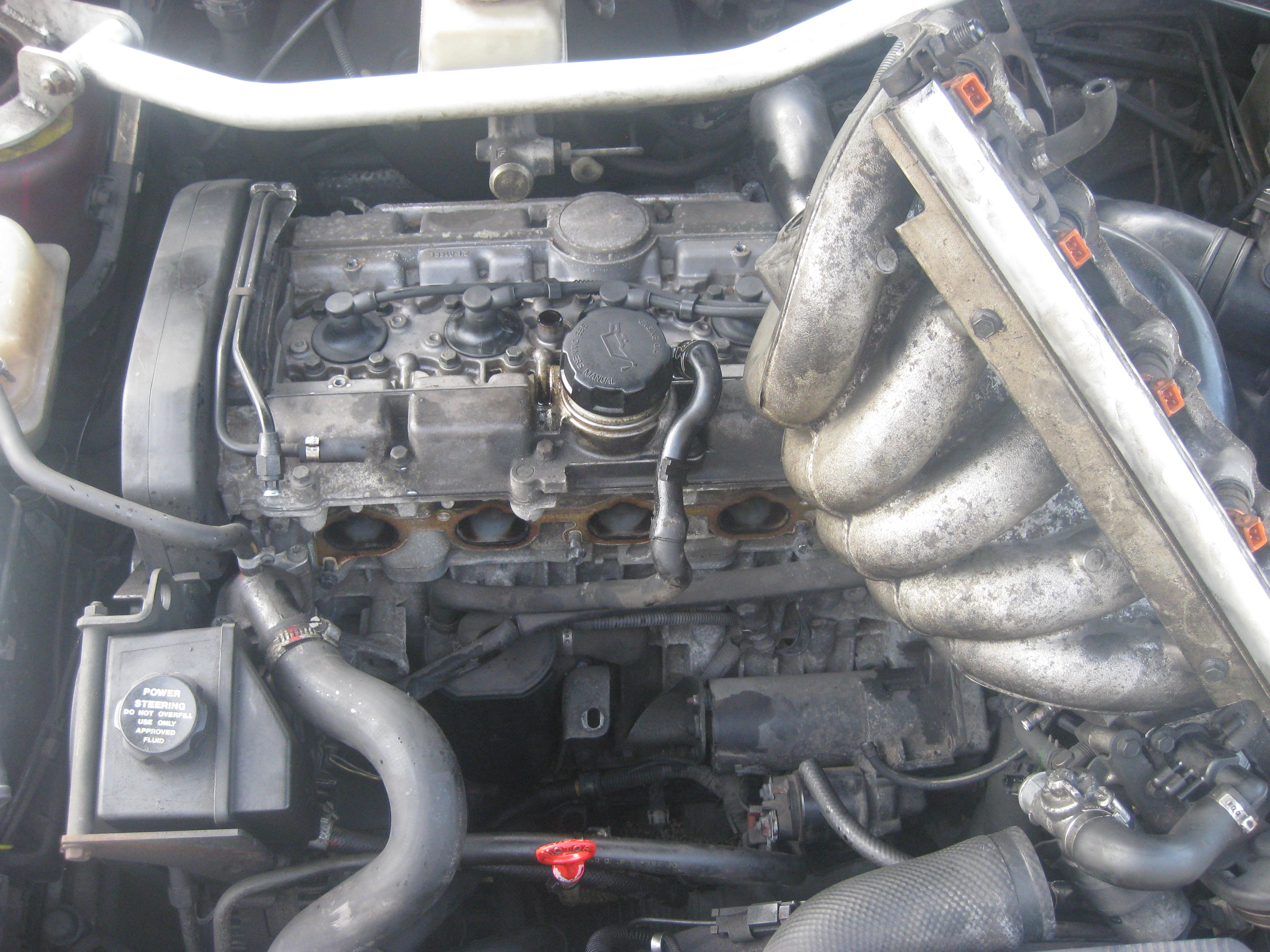

I thought I would update everyone with the current situation. I am getting the car looked at on Thursday but all indications point to a failed rear crank seal. I lost nearly 2 quarts of oil since Friday, it is blowing out past the seal and under the bottom of the car. I have the tell tail spots of oil all over the tailgate. Also the dipstick was pushed right out of its sleeve and oile was all over the top of the engine. Worst is going to be the clean up!!
Anyway, I surprised myself and completed a full pcv system overhaul in 3hrs!! I did my first one 18 months ago. Wish I had the confidence to do the RMS. So the garage are going to quote me on Thursday for replacing the rear main seal.
I really like the car, it has 151,000 miles and runs very well. I think it is worth repairing even though it is 17 years old. I don't think I could find another T5 or turbo that would compare unless the owner has done all the necessary maintenance.
Here are some photo's of my pcv work.
Regards
Matt
The breather box and the 2 holes in the block were clear.
The hoses weren't in good shape, the large hose had a split in it and the small vacuum hose was blocked solid.  I don't think the pcv was doing its job but I don't think it was the cause of the rms failure.  Hopefully the engine isn't too worn and causing excessive blowby.
