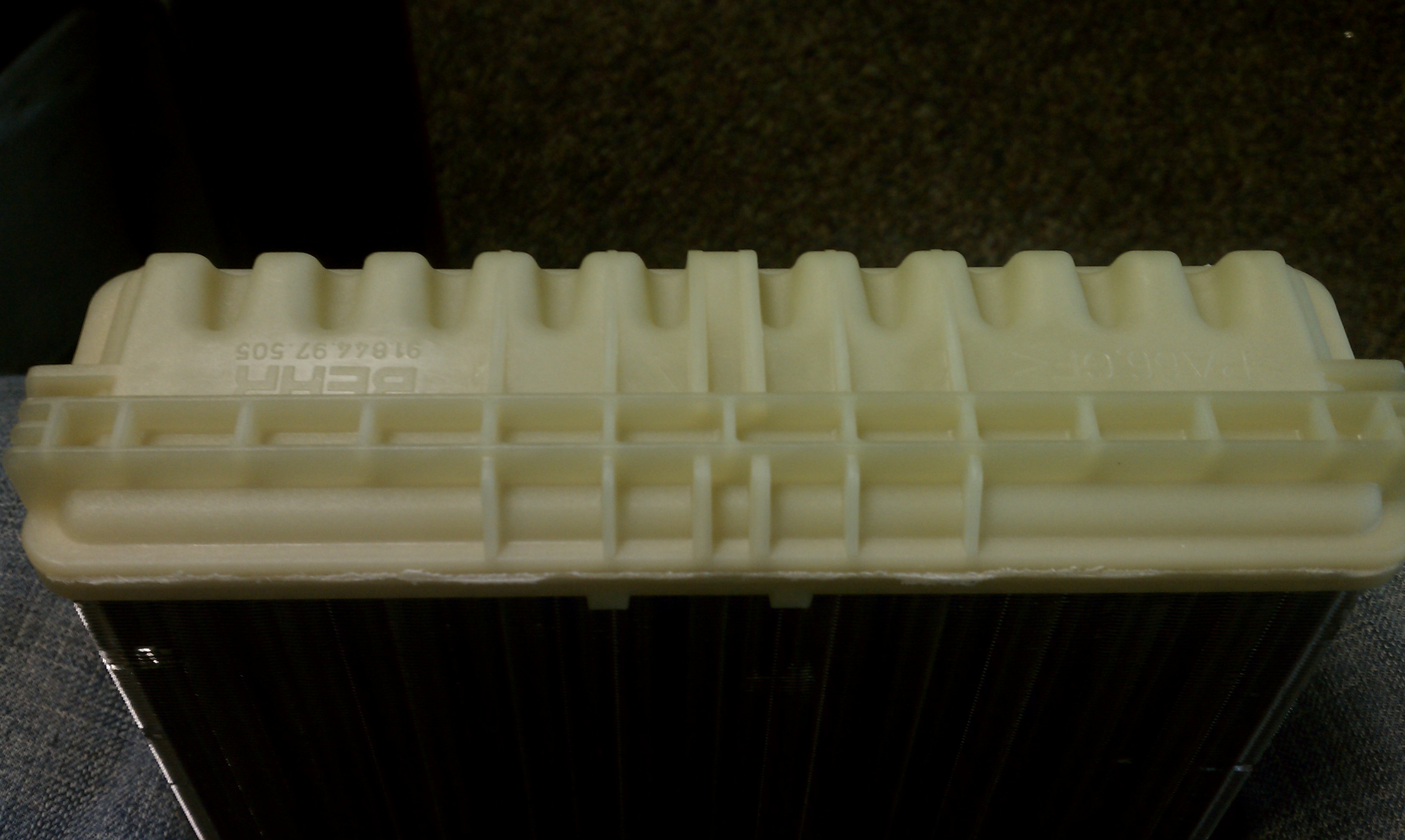

So, the new OEM core came in today from FCP. Notice the reinforcing at the top, exactly where the aftermarket version failed? That's not there to make it pretty. Volvo engineers recognized a weakness in that location and designed a structure that could withstand the pressures and stresses. Hopefully, the aftermarket part manufacturer will do the same.
SilverS70

I had the same experience as the original poster. My aftermarket heater core purchased on ebay from FCP also burst and it matches those pics posted exactly, one huge crack along plastic. Happened after about 4 months. I didn't want the hassle trying to get it replaced(buy another new one, ship old one back, then get refund) with another aftermarket core, so I bought the volvo original. Its been fine ever since, I had a shop pressure test the system too.
I think it is well documented that the heat output is very inferior too. I like FCP and will buy from them again, but the cheap aftermarket heater core is a poor product.

Just to follow up on this thread, I got the OEM core in and it's working great. FCP Groton refunded my money for the failed unit and, other than having to pay to ship it back and having to do the change twice, I'm content.
