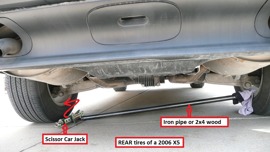

OLD post, but I just came up with this idea.
I have NOT tried it yet but if anyone tries this, please post an update.
Instead of hammering the inner part of the wheel with wood + hammer combo, let's say you jack up the LR tire:
- Use a iron pipe or 2x4 wood long enough to wedge against the good side.
- In other words, jack up and remove the 5 lugs on LR side but leave RR side alone.
- Ask an assistant to hold the iron pipe or 2x4 wood, then use a scissor jack to jack the stuck wheel OUTWARD.
- The force of a scissor jack should be enough to dislodge a stuck wheel.
- Then add antiseize as mentioned.
Any thoughts?

Ifs impact you want , not force. You can build up a lot of stored energy in that jack combo which can do a lot of damage underneath when it slips
The jack weighs a lot less than the wheel tire combo so when the wheel moves the energy will go into both
