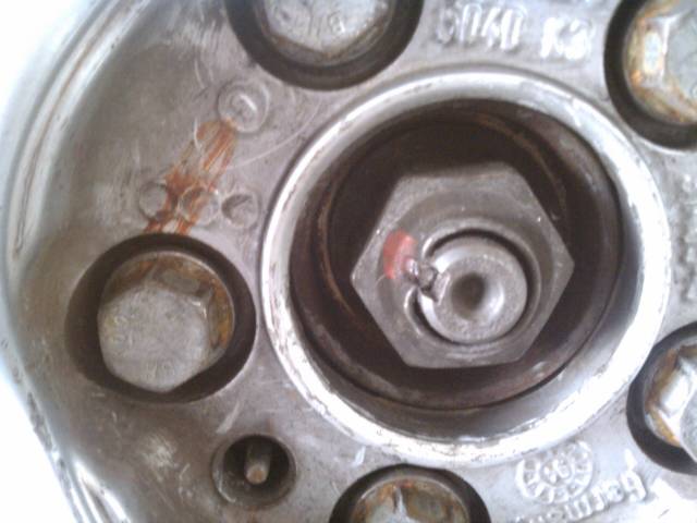

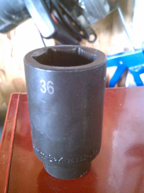

Man am I having a heck of a time getting off the 36mm nut

Just stating the obvious here...you did unstake it right? I have a $30 Kobalt impact that ripped thru that (since upgraded) but doing it by hand it probably would need to be unstaked before you twist it off.
Also I do own a 36mm Craftsman socket (Craftsman 36mm only comes in shallow 12 point), but my SK 36mm 6 point deep is a better fit. Not sure if you are using a deep or shallow socket but the shallow won't go all the way on the nut, and you risk buggering it up. FYI Advance Auto Parts "rents" deep axle nut sockets with 36mm in it (IIRC) for $50 but you get your $$ back when you return it.
In addition, you just need to go buy an iron pipe. Take your breaker bar with you to Home Depot and get one. They are fairly cheap.
