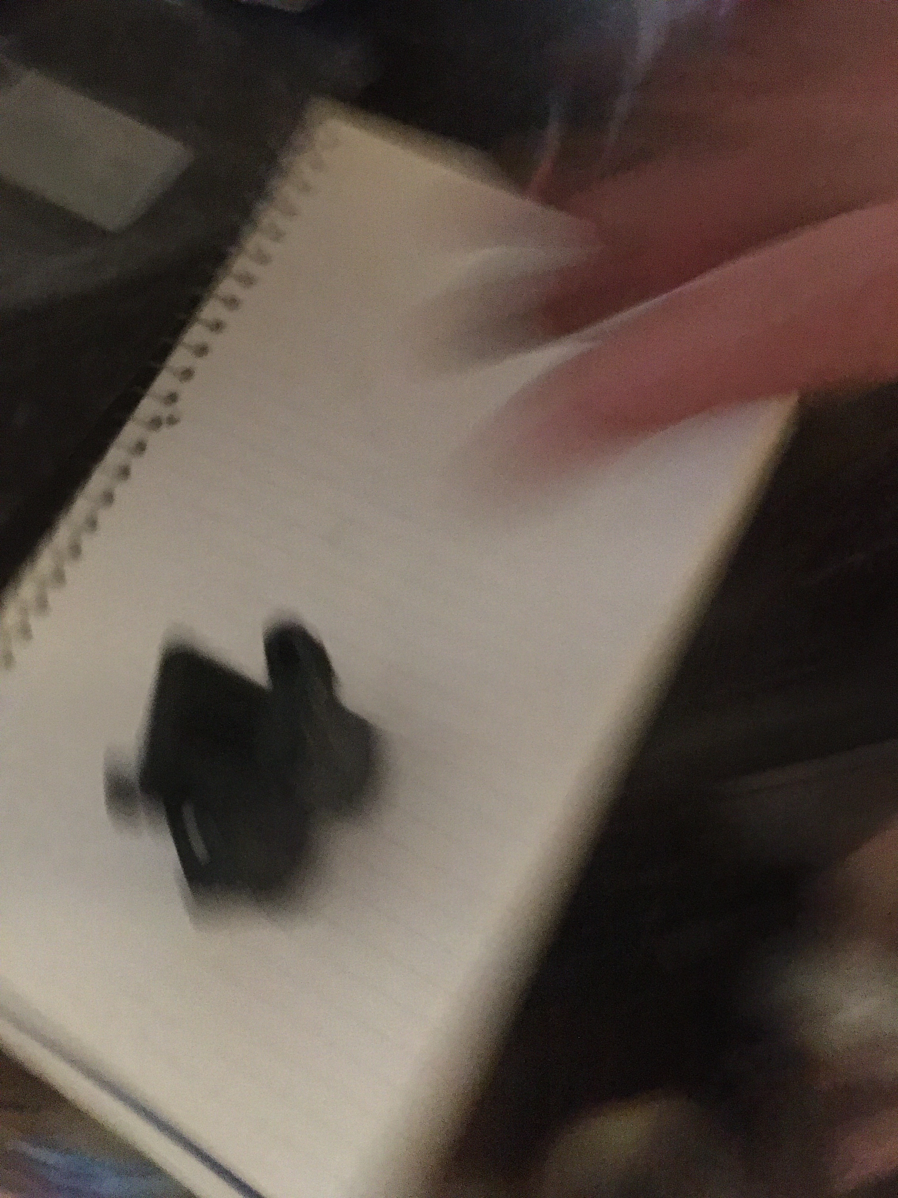

That's cute. You're a genius. I found it. Put your picture up and I will kiss the computer screen, Look at my hand after pulling it up from right at the edge of the radiator. Hey, guess what I might have to beg for you to have the honor of also please) telling me how it goes on -- before my hand gets any blacker and greaser! All image search did not (so-far) with part number show the actually active position! Thanks again...

The black 'pointy part' fits against the side of the battery.
If you look along the side of the battery tray you will see notches along the front of it about every 1".
The battery should have a lip along the front and rear and also the sides around the bottom. You have to drop it in slightly tilted back toward the windshield to allow the lip to go under the lip on the back of the battery tray. Once it is under there, slide the battery toward the inner fender with the Vin plate on it to lock the lip of the battery on 2 sides.
The battery clip then rotates from the top downwards at the LH end of the battery viewed from the front of the car.
Why the heck am I writing this? Just watch Roberts Youtube how to. This is great. Once you get to about 1min 30 secs in you see how it fits.

Thanks! at 2:40 he actually shows how the clip comes out. See I thought it slid on from the side -- which didn't make a whole lot of sense becasue there isn't much room to thread it around from the side.
