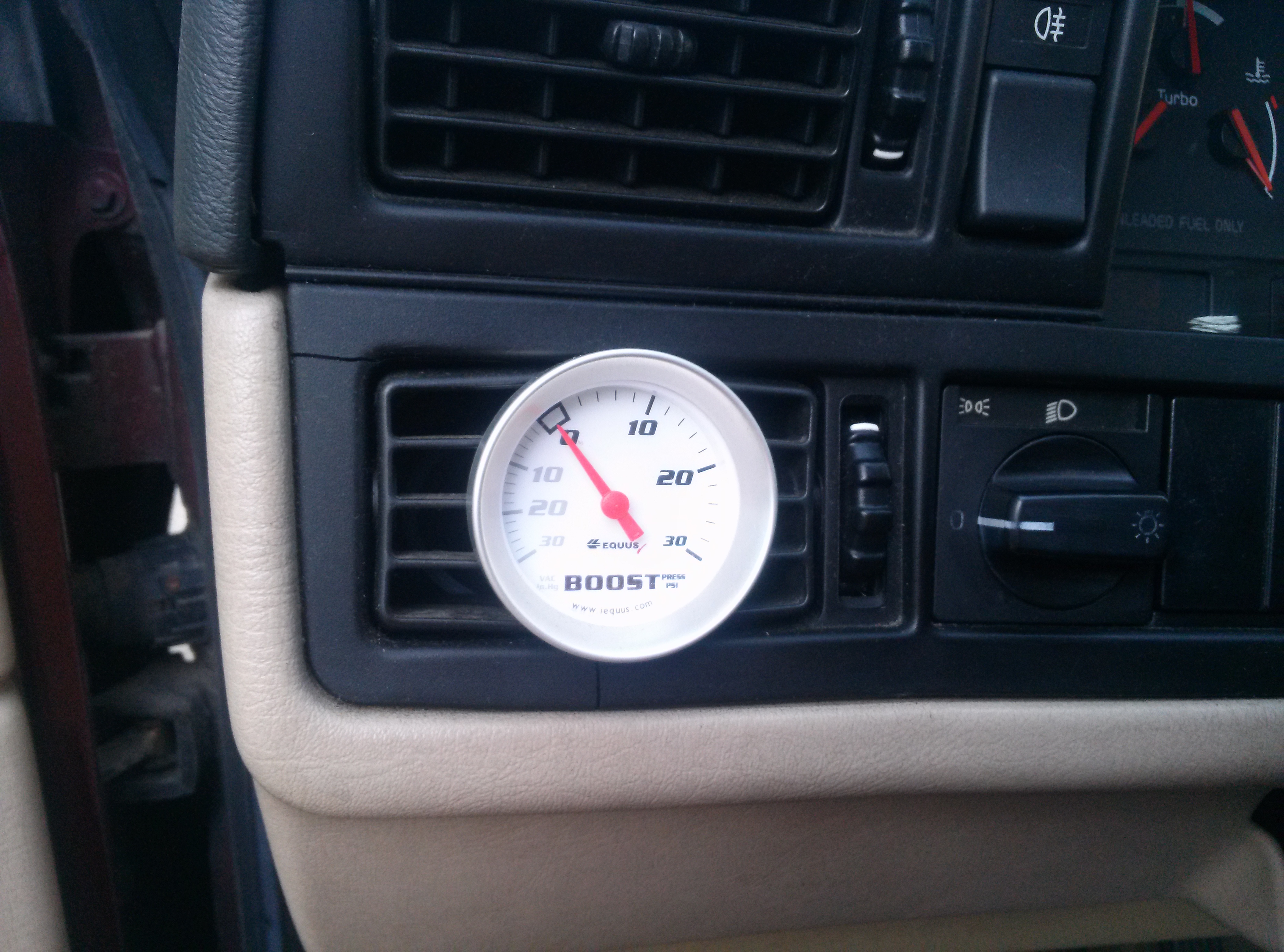

I installed my boost gauge in the lower hvac vent on my 850. I was able to T off the factory boost gauge line, and splice into the dimmer switch.
I wanted to remain "stealthy", and not have it on the pillar. Easy to remove, and the only part I cut was the diffuser for the vent. I have a few spares if I ever decide to delete the gauge. It's an equus gauge I got from orilleys. Works well.

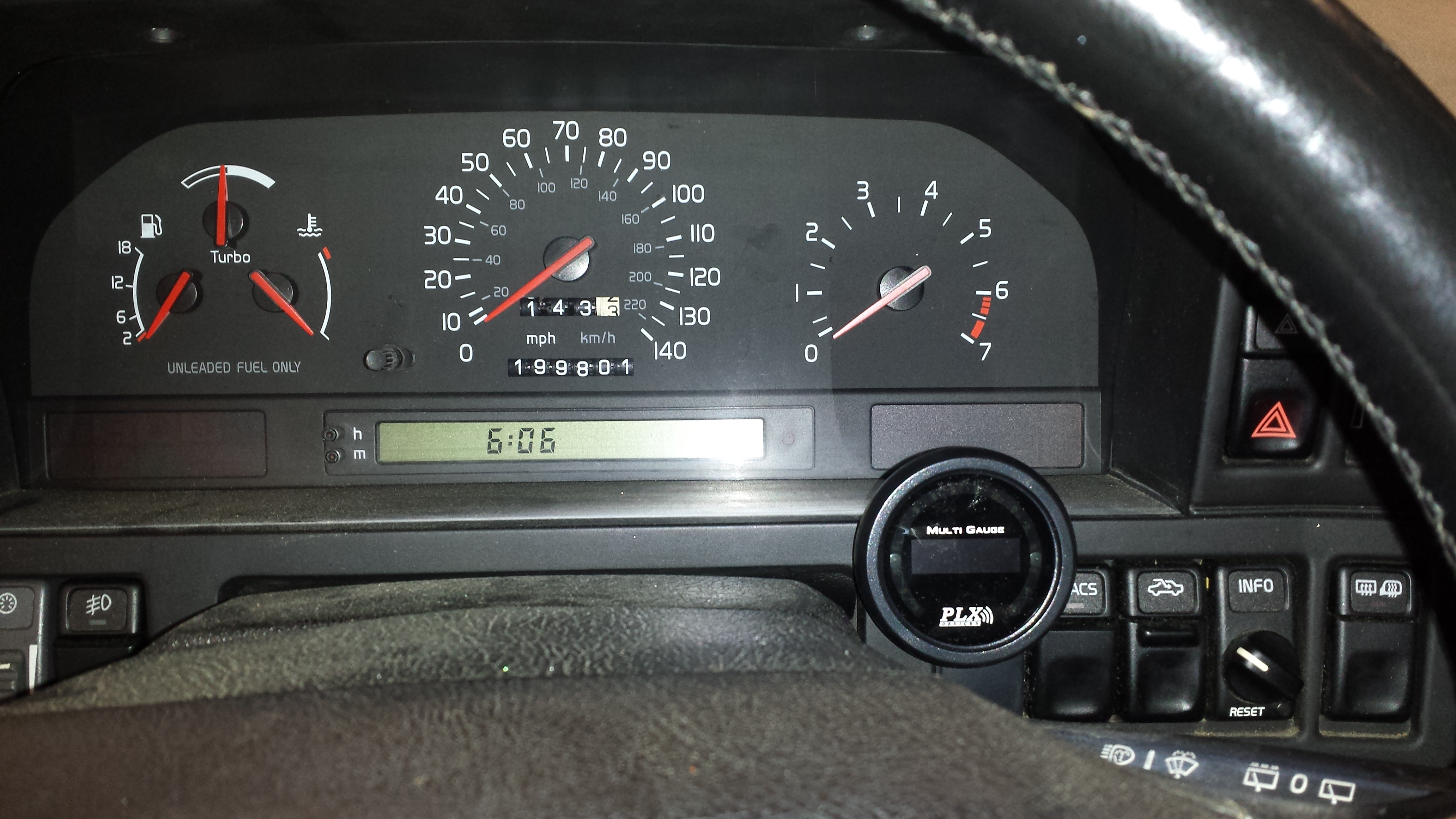

I put mine on a mount made from some wire in a hole I drilled in one of the blanks behind the wheel on the right.
Have both a wideband and boost gauge connected to that gauge, will probably add more sensors to it later.
