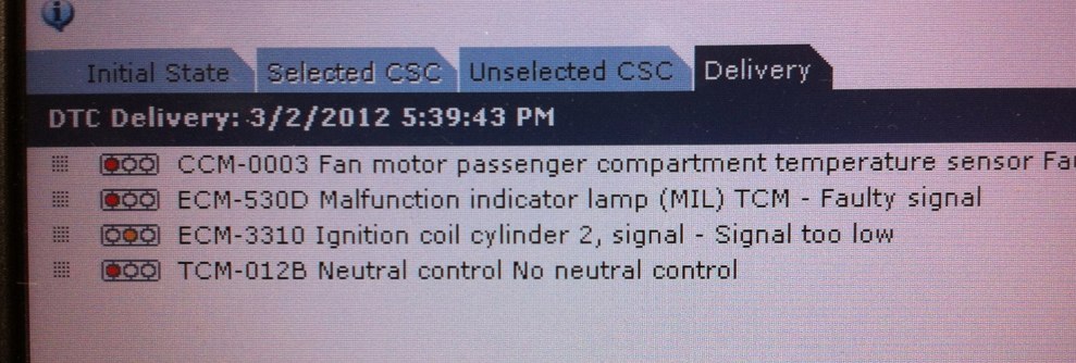

OK, just pulled the code and it's not a fluid reset (although I would still like to know where todo that...)
It came up: TCM-012B Neutral control No neutral control
Is this the neutral stop control checking out, or just taking itself offline?
I've included a screenshot...please ignore the ECM-3310, I'll be putting a new 02 sensor on in the following weeks (per Jimmy) but I don't know what the ECM-530D is, this is a new one!

I'll also add again that it drives no better or worse then prior to the MIL/CSC. In both full automatic and geartronic mode it's happy...and the neutral stop is still felt at stop and go. So this error didn't take the software functionality offline : (
I read somewhere this code can point to replaceable valvebodies, but am curious to all this great helps experience. I need one more year out of this car! If I'm not feeling anything different what would you suggest?

The no neutral control dtc is a new one on me. I would have to read the code info listed to see what TCM must detect in order to set that code. My seat of the pants assumption would be that it is pulsing the clutch solenoid to a % that should disengage gear and let input drum speed sensor go to engine idle speed or close and it is seeing the speed input at 0 rpm which is what you'd have when it is in gear.
