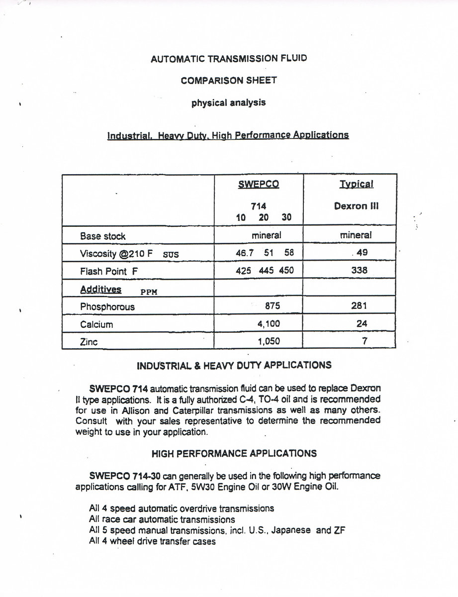

Swepo 714 30W Transmission oil is suitable for high performance engine oil also. They have always been way ahead of the curve.
Swepco on Synthetics
http://www.swepcousa.com/lubesite/tt899.htm
