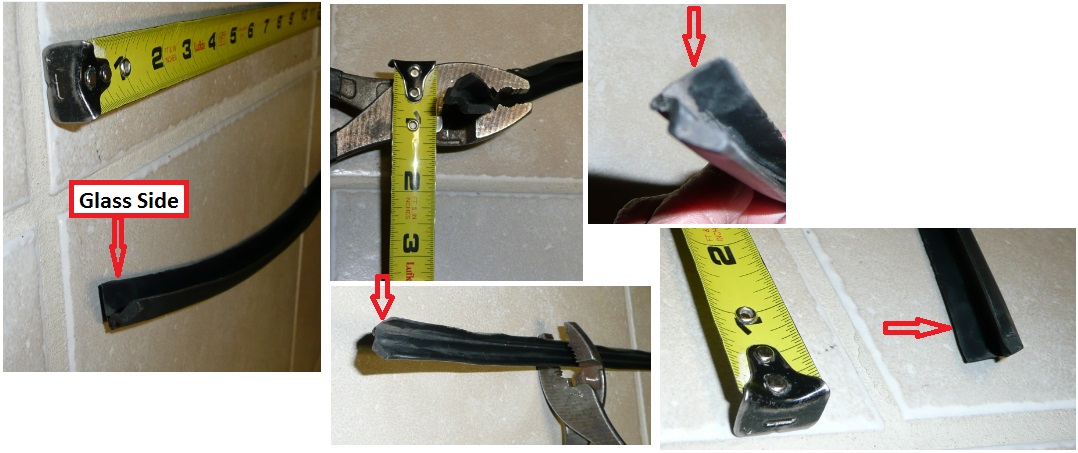

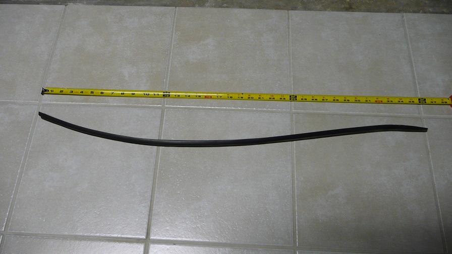

- Posts: 8251
- Joined: 31 March 2010
- Location: Omaha NE
- Been thanked: 466 times
- Here are some photos from a 2002 S60 molding I took from the junk yard. I just peeled the rubber part from the trim piece.
- It is not in a good shape, but I took it strictly for photography purposes in case you guys come up with something decent to replace this piece (someone posted a photo using garage door bottom seal).
